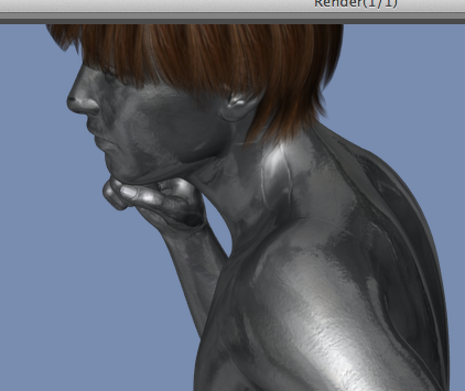

  • thibautrobinthibautrobin Posts: 0
    Hello its hard to explain because iam french
    and i don't have all the vocabulary i need to describe what happen but here are a capture of a render
    in C4D with the SILVER MAT i bought on DAZ3D.COM
    and after that you can see when i import the animation in C4D the texture is horrible
    ther must be a way but iam learning c4d im just using it since 4 week... and i didn't learned at school
    so i miss some basics...
    Thank you if you can help me.

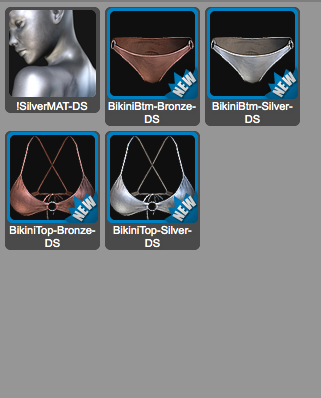

    This what i use Silver MAT
    321 x 398 - 62K
  • prixatprixat Posts: 1,630
    The import will never be perfect.
    It will always need fixing in c4d.
    I would forget about improving the import and just rebuild the material in c4d.
    Try one of the c4d presets: 'metal 009'. That is quite close to silver.
  • umblefuglyumblefugly Posts: 249
    In order for your renderer to "see" the reflections, you need something in your scene to actually reflect. You cannot have just a black background.
    so this is like daz Studio sort-of, it still needs something to reflect, and that something needs to be illuminated. And stuff made from the ground up for the program will always work better then anything imported.
    Ok Thank you ill try other way
    But if someone knows how to do maybe i jsut have to put a HDRI on a "SKY"
    and try...
    Thank you for your answers!
  • AscaniaAscania Posts: 1,856
    and try...
    Pre-made example-skies and HDRI materials can be found in the Content Browser. Just don't forget to put on a Render tag and turn 'visibl to camera' off.
