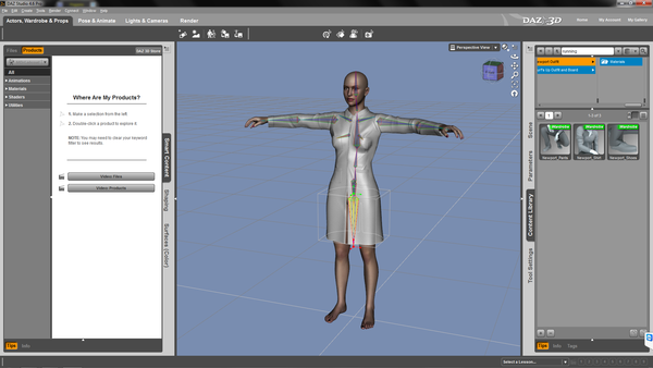

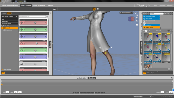

    Been messing around a little and found something odd.
    When I browse through the MDrLabcoat tree, I can see bones for left shin and right shin but changing any of the values (bend, rotation etc.) doesn't seem to have any effect. In the view pane where it usually places white box markers around the area selected, there are none, but it has the x/y/z arrow manipulator. So I click the box (clicking and dragging on the arrows didn't seem to do anything) and drag it slightly and behold, that half of the bottom of the coat bends to match the angle of the leg!
    The weird part, as soon as I let go though, it goes right back to it's original position :(
    here's a couple screen shots of what I'm talking about.

  • kaotkblisskaotkbliss Posts: 2,918
    edited May 2014
    A new update since I found the "joint editor" tool.
    I'm pretty confused now as the layout tree on the left has a left shin and right shin bone listed for the lab coat but when I go into the joint editor to link those bones to the models thigh bones, there is only a single series of bones going down the middle of the model. It doesn't split off into a left/right side at the pelvic area as I would have thought.
    Is there a way to add bones and remap faces so I can split the bottom portion of the coat to left/right sides?

    The Shin and Thigh bone are hidden, that's why you don't see them. They are there, if anything, to make the coat sit better - sometimes if the chain of bones stops to soon the result can be odd posing. The bone you see is the LabCoat bone, which is an example of a body handle (or ghost bone) that you can pose independently of the figure, to adjust the drape of the clothes - in this case, presumably, the coat relies mainly on morphs rather than bones.

    I don't see a pink rotation dial, unless you mean the "bend" slider bar. But so far any attempt to move the 2 halves separately from each other shows the half moving as I want while I have the left mouse button down and I'm making the adjustments. As soon as I release the mouse button, the half of the coat I'm adjusting "snaps" back into it's original position (and the lock icon in the slider bars is in the unlock position)
