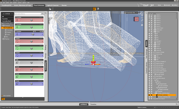

    Scratch Dform in Daz Studio 4.6, it is completely broken. The field refuses to highlight any of the polygons of the skirt, and moving the handle dose nothing after releasing the mouse button.
    The funny thing is, when I move the handle in any axes, the dress auto-conforms to the floor boundary (only when I'm moving the slider). Something somewhere knows about the floor, and it snaps back to broken the instant I release the mouse button.
    Yes I did try to "Add Nodes" to no avail. Dform is broken.

    DFormer works fine for me, although I have not updated to the latest version of Daz yet.
  • scorpioscorpio Posts: 8,534
    edited May 2014
    Odd I use Dforms all the time, I'm on the latest version of DS.

    O.K what part of my steps in that other thread are wrong then? If it works for y'all, then I'm doing something wrong, yes bring that thread back rather then here, I had no intention of hijacking this thread.

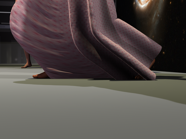

    Going on the thought that "Some things don't show till rendered", the bottom of the skirt should be up around her head in this render, lol.
    As for the stretching texture on the inside of her right leg, a custom texture map with the texture distorted the opposite way the polygons are stretched may work. That is a lot of work to do for many possible poses, akin to what "Aave Nainen" did with that dress in the demo vid.

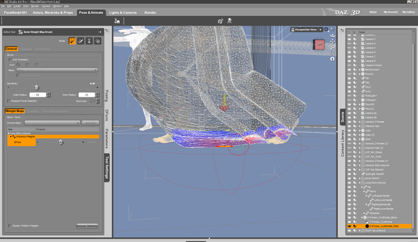

    The DForm works on the zeroed pose of the item - in your case that would probably mean that the field needed to be away from the skirt. One option is to switch to the Node Weight Brush tool and in the Tool Settings pane, with the DForm selected, add its weight map to the available maps and then use the Geometry Editor tool with the brush tool to assign polygons to be influenced - that will also make it easier to achieve folder.
    Using dynamics you can do an animated drape for a still render - you just set up your animation (roughly since only the final frame matters), starting with a zeroed pose in the frame 0, and then do the animated drape to the final frame which is all you render.
    two seconds fumbling around menus, and walla!
    Thank you,Thank you,Thank you.
    1917 x 1113 - 629K
    I am tempted to call this "Wilmap skirt in motion", tho the right leg needs a tad bit more work. Now I am impressed after a month of Dform failures, it's finally doing something with cloth.
