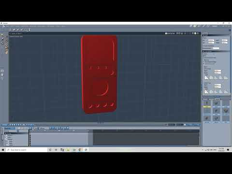

    the voltmeter parts are all spline objects and open in the spline room
  • TorquinoxTorquinox Posts: 4,856
    I took a look at that voltmeter. The video is not helpful to answering the questions. The top layer has a lot of splines that seem to be inaccessible to the selection tool. I don't use spline modeler that much. So, I'm not sure how to access those curves, either. Also, the degree of subdivision along the curved edges looks pretty low. Not sure how to make the skin surface smoother. Finally, I notice that converting that model to polys so that it can be edited in the vertex room produces a horrible-looking mesh. Surface topology is very poor! So, the real question is, how do we properly edit that model? And how was that particular model made?
  • WendyLuvsCatzWendyLuvsCatz Posts: 41,504
    the video was just a quick look by me in reply to the question to show that they are in fact models
    not a tutorial blush
    It's been a while since I've done much using the Spline Modeler, but I took a look. Here are some screen grabs that might help.
    You create shapes on cross sections and can navigate to those cross sections using Sections > Go to (or Previous or Next). In this case I used the 'Go to' and entered cross section 3. I then selection the object and went to Edit > Ungroup:
    From there the smaller pieces could be selected and I could go to Arrange > Break Apart Compound:
    Here, as an example,I was able to select just the circle and the outer rectangle and used Arrange > Combine as Compound:
    And got this:
    And finally, here I just selected various pieces and dragged them out and tried to see what could be further broken apart:
