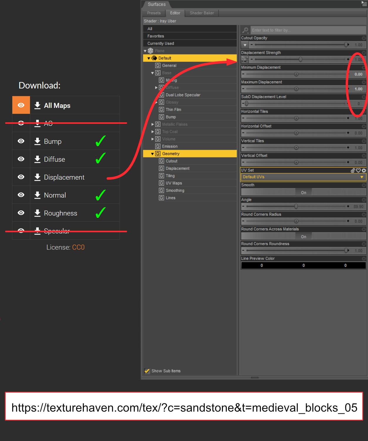

    Here is an example for Iray rendering using the Iray Uber shader.
    Try the following for the texture https://texturehaven.com/tex/?c=sandstone&t=medieval_blocks_05:
    1) In DAZ Studio create a primitive plane (Menu → Create → New Primitive...) with Size 50 cm and 200 Divisions
    2) Select the plane and open the Surfaces tab. Now plug in the textures from Texture Haven into the appropriate Iray Uber shader slots like shown in the images
    2a) Diffuse → Base Color
    2b) Roughness → Glossy Roughness (Tweak the value if necessary)
    2c) Bump → Base Bump (Tweak the value if necessary)
    2d) Normal → Normal Map
    2e) Tweak the value for Glossy Layered Weight if necessary
    Setup for Texture Haven stone textures for Iray Uber shader part 1
    Optional for close up shots:
    3a) Displacement → Displacement Strength (also tweak the value itself)
    3b) Tweak the values for Minimum Displacement, Maximum Displacement and the SubD Displacement Level, when e.g. your geometry has not enough vertices

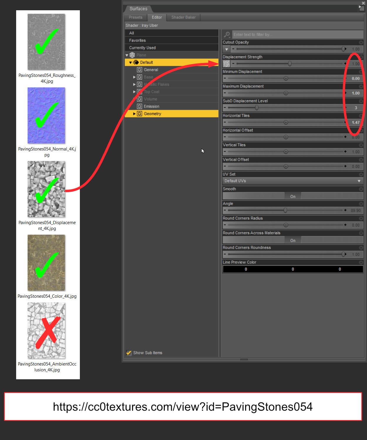

    Here is a second example for Iray rendering using the Iray Uber shader.
    Try the following for the texture https://cc0textures.com/view?id=PavingStones054:
    2a) Color → Base Color
    2c) Normal → Normal Map
    2d) Tweak the value for Glossy Layered Weight if necessary
    Setup for cc0textures stone textures for Iray Uber shader part 1
    Setup for cc0textures stone textures for Iray Uber shader part 2
    4) Fix non square aspect ratio of texture:
        Most of the times textures are square and thus have an ascpect ration of 1:1. For this example however the texture is 2791 pixels wide and 4096 pixels high for the 4K version of the texture. However the Iray Uber shader expects a square texture. To fix the distortion you can do the following:
    4a) Set either the Horizontal Tiles value to 1.467574346112504  This is calculated by 4096 / 2791
    4b) Set the Vertical Tiles value to 0.681396484375 This is calculated by 2791 / 4096
    This is how the rendered plane looks when the Displacement map is used and one of the above aspect ratio fixes has been applied. In this case however it is not really noticable when you don't fix the aspect ratio!
    xample result for the texture PavongStones054 from cc0textures rendered with Iray and DAZ Studio
    1250 x 1500 - 346K
    1250 x 1500 - 270K
    1024 x 1024 - 2M
    Post edited by markusmatern on

  • markusmaternmarkusmatern Posts: 612
    Loony said:
    Hmmm... I am not sure if that would do the finetuning. I would prefer a Real human eye who take the time to adjust it and finetune it, like I said I would support it.
    I think it is all about the tuning. But not in a generic way but tuned for the exact scene you are working on. For example you have to decide about the resolution of the initial maps 1K, 2K, 4K or even higher.
    Then you have to decide about using bump and normal and height map or only one of them and maybe in a different resolution. Do you want to use JPG or PNG maps and maybe the 16 bit variants? This can make a huge difference for close up shots for the height map. But only when you have enough geometry.
    This gets quickly out of hand in terms of possible combinations. So I think it is better to have a basic recipe and tune it for yourself for your specific purpose.
    Loony said:
    hmm, I never made that :o Only maybe adjusted glossiness. Or Displacement to make things more filled/thicker.
    Did yu thinked about, the idea to make a base version of the textures for daz3d? A Premade set.
    As I stated above there are just too many possibillities for even a single texture. Much less all the textures from the mentioned free sites. I can't do that.
