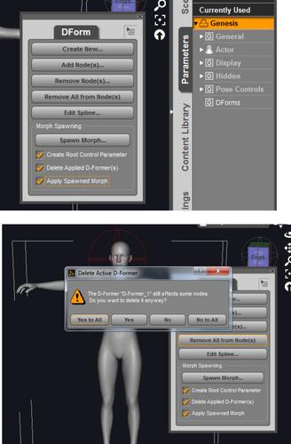

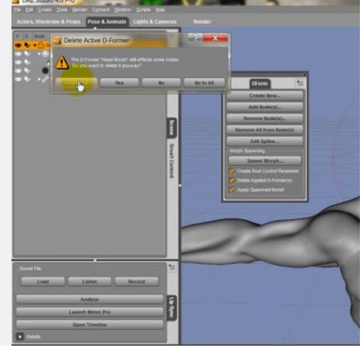

    Did you actually used dformer to make a change to the figure?........ Which is as it should be because there wasnt any actual change to the figure so there wasnt any morph spawned even if spawn morph procedure went through.
    I feel badly- ben98120000 was actually right on target, solved it first, and I missed it! Thank you so much!

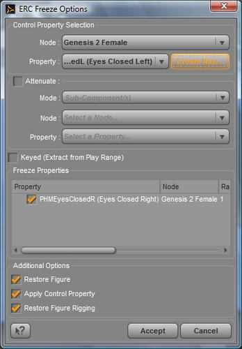

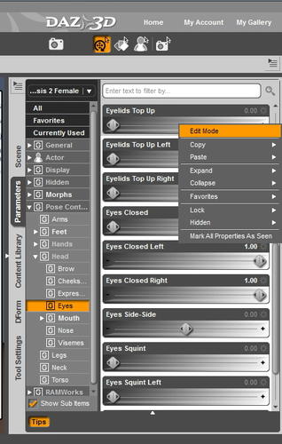

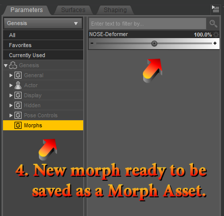

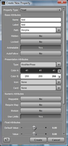

  • ben98120000ben98120000 Posts: 469
    edited May 2014
    Novica said:
    I would still like to know how to combine morphs into a master dial though- I know it can't be as simple as having two morphs in Scene tab and then parenting one to the other. (I wish.) I have morphs for the nose and would like to have each nostril individually, but also one master dial.

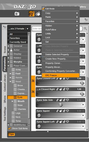

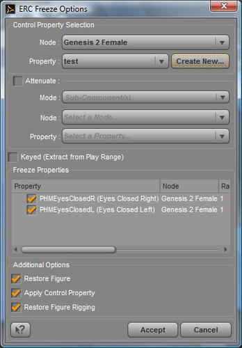

    Heres one way to do it:
    1. Dial up morphs you wish to make a master dial for, to their max value.

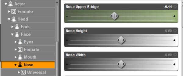

    2. Click with right mouse button on the parameters tab or anywhere inside parameters tab to get a menu and from the menu activate Edit Mode. (pic1, clip_21) While in edit mode click with right mouse button on one of the morphs to get a menu and from menu select ERC Freeze... (pic2, clip_22).

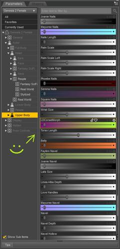

    3. In ERC Freeze Options window (pic3, clip_23), under properties, click on Create New.

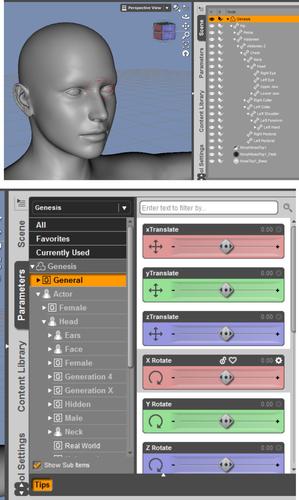

    4. In Create New Property window (pic4, clip_24), leave property type as "float", type in unique name (if the name is already in use, property wont be created), path (menu you wish master dial to appear), type and you can adjust other parameters to your liking. When you are done click on "Create" to create new property.

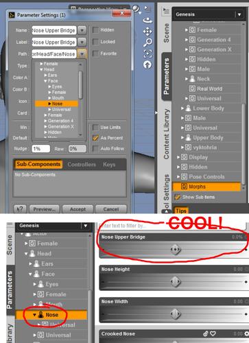

    5. Now, in ERC Freeze Options window (pic5, clip_25), property you created should be listed in property field and morphs you dialed and should be listed and activated in Freeze properties field. Click "accept" and your new master dial will be created in the menu you picked.
    6. Save your master dial as morph asset.
    EDIT: Apparently, when you make new properties, it will automatically add in freeze properties field anything that is active or not zeroed out when you make the property, so theres no need for selecting active morphs prior to ERC Freeze. They will be added just by being active.
