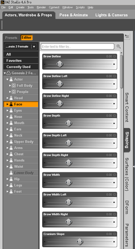

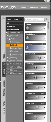

    also, "Parameters"? I see morphs in the "Shaping" tab for the Genesis and Genesis2 figures. Is it different for older characters?
    Note, I got the Genesis2 morph stuff, so it may be different sliders for V4/V4.2 morphs.
    total brain-fart, yes there is much more controls in the "Parameters" then in the "Shaping" tab. What was I thinking.
    If done correct you should see all morphs for all figures in Parameters (in the morphs section, if full body not selected). But the Shaping Tab is new and came with Genesis, I've never looked in Shaping once for morphs. I come from years of the older DAZ Studio's and expect morphs in Parameters.
    On that note, I will look at Shaping and check all my figures just to see what I see.
  • fixmypcmikefixmypcmike Posts: 19,708
    There's a setting in the morph data file to indicate whether it should appear on the Shaping or Pose tab -- if it isn't set then the morph will only appear on the Parameters tab.

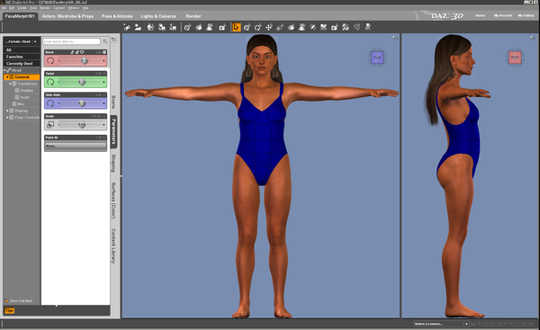

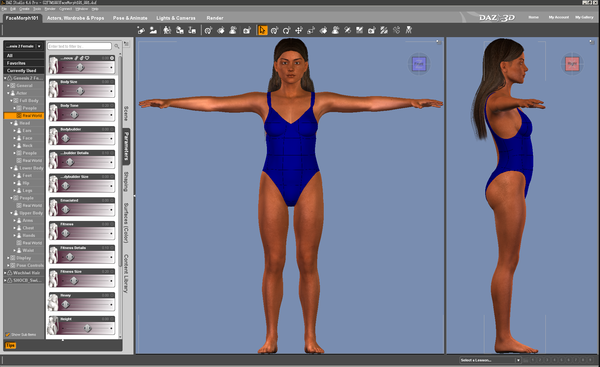

    edited May 2014
    He's correct I think. I was just setting up that new room and low and behold, Morphs is not in the new "Parameters" tab. If the 'root' figure is not selected. Note it has "Head" next to the 'bone' not "Genesis 2 Fe...".
    It may be an install path issue as well.

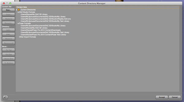

    Can you post a screenshot of your Content Directory Manager showing the DS-formats and Poser formats?
  • RLSprouseRLSprouse Posts: 288
    Like this?
    1147 x 634 - 85K
    Do you have a "Runtime:Libraries:!DAZ:Victoria 4" folder in more than one of those Poser-format locations?
    Mike, it turns out I did have that folder in two of the Poser-format locations. By trial-and-error, I was able to rename the extra one and now I have my Morphs++ dials back in place. Thank you very much!
