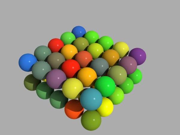

    Just to add an image that shows the results of the above color Mixing, you can see that each sphere has a random mix of the different starting colors. But you don't need to be limited to plain colors, you can have patterns, texture maps, whatever...

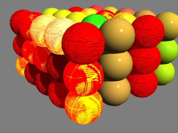

    Fantastic plug-in that needs more experimentation.
    appears to work with grouping and texture. Shader balls and a plaid texture here using a mixer to get variations.
    Materials, carpet, mixed vegetation come to mind - will have to experiment more

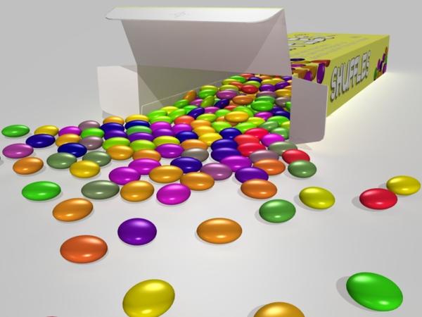

    This is a preview of a product I have been working on which uses the Instance Randomizer. The product will include this scene and everything in it.
