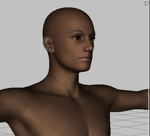

If you own the V4 UV for G2F, you can copy over the UV file from G2F to G2M data directory and then edit the file path in the "id" in the file ("Female" -> "Male"). The attached screenshot is Elite Marie V4 on G2M. If I am not mistaken you can even trigger this via certain presets, so that G2M switches over to a G2F UV, but this is how I did this initially.
