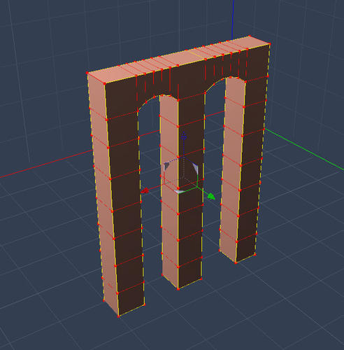

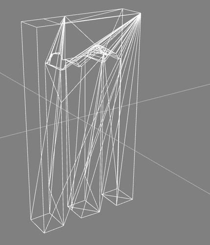

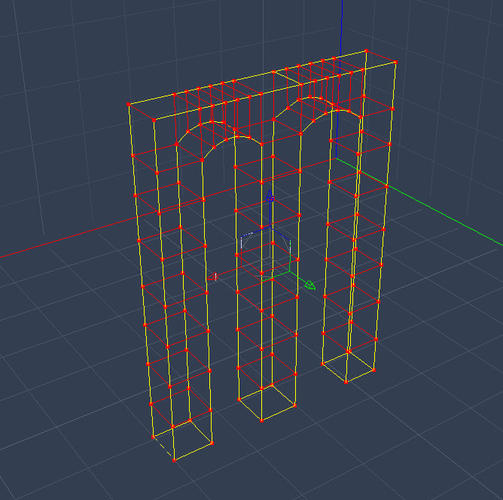

I am putting in two pictures to show what I am talking about. I am not suggesting that my first mesh is beautiful but it is an example I have saved and shows what I am talking about.

    All 3d apps reconstruct obj meshes to their own approach - so while the vertices will be at the same coordinates, the coordinate scale, subdivision, the sequence and smoothing may differ between apps. Its to be expected. There may not be much difference when rendered.

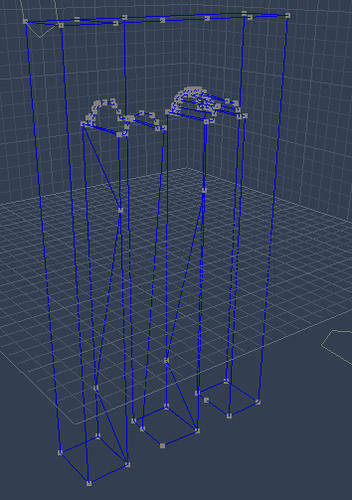

  • 3DAGE3DAGE Posts: 3,321
    HI and Welcome :)
    This is the conversion of Polygons to Triangles, either on export from Carrara, or import into DS.
    Unfortunately the main problem with the "legs" is caused by your model.
    the first leg, is a square,. (four points) the other two have five for some reason, so there are N-gon's and Tri's in there with Quads.
    most programs will try to correct the faces of an object and respect the edge creasing,.
    sometimes if your object isn't made correctly, the this can lead to an edge being extended to it's next relative point, which is why some parts of the legs are crossing over, ..hiding the arched sections.
    Build using quads whenever possible,. keep the object definition as regular as possible,.
    here's a quick and nasty example and wire-frame view.
    Hope it helps :)
    668 x 664 - 111K
    669 x 680 - 82K
    Your middle leg has the top corner joined to the middle of one side. This is creating a non-planar polygon (i.e. it isn't flat). Studio and Poser can barf over non-planar ploys, so you need either to correct the mesh, or triangulate non-planar faces in Carrara before you export (if it's deliberate).
    The tris on the other legs suggest to me that maybe there's some twist built into them too.
    Doing like 3DAge suggests and keeping to regular quads wherever possible will help spot issues like that, as well as keeping the model neat and tidy.

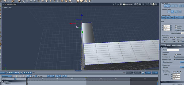

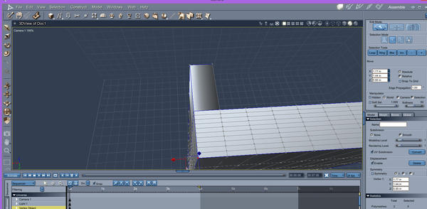

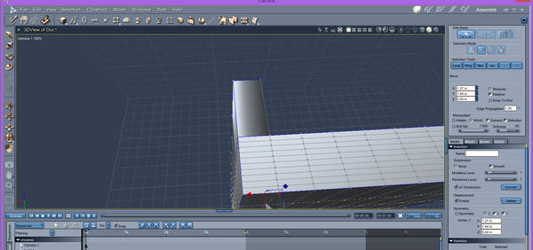

    I am putting in four pictures to show the trouble I am having. I hope they are in the correct order. I could not get a picture that showed the numbers in the boxes, so I am listing them below.
    The coordinates of the point that is selected in picture one is
    1.77, 1.44, 5.00
    The coordinates of the point that is selected in picture two is
    1.27, 1.44, 5.00
    The different being about .5 inches. The problem is that the length is 6.25, and since it is split into ten units, it should be .65 not .5
    The coordinates of the point that is selected in picture three is
    1.77, -3.56, 5.00
    The coordinate of the point that is selected in picture four is
    1.77. 10.06, 5.00
    The problem with this is two fold. First, I told it to extrude in the offset box by 6.5 and it appears to have set the coordinate at 13.5 distance. The second problem is that, the length of the line that was created was not the correct length.
    I hope that my pictures and explanation makes sense of the problem I am having. Please let me know if I should be breaking these questions into separate topics here. I am new to the forum and am not sure the way that is desired.
    1507 x 695 - 246K
    1502 x 688 - 235K
    1600 x 751 - 276K
    1569 x 769 - 273K
  • DartanbeckDartanbeck Posts: 22,156
    edited May 2014
    lulamfada said:
    Please let me know if I should be breaking these questions into separate topics here. I am new to the forum and am not sure the way that is desired.Whew! At least I can answer one of these! :)
    This is your thread, and it is all related... I think that keeping it all together is most helpful.
    I model differently that this. What do you mean "I told it to extrude"? Are you using the dynamic extrusion tool?
    If you select an edge or polygon, and have the Scale Tool selected, you may enter in exact amounts along any of the three axis in the panel on the right.
    I should also mention that you may enter any unit of measure you like, even if it displays something else. In the "Units Example" in the illustration, notice that the current unit is set to 'Feet' (Ft). I enter in 55mm in the box under "A", and when I hit Enter, the results are shown in the box below "B" and the example of the change is shown to its right.
    HI lulamfada :)
    Firstly, the "offset" in the extrusion options doesn't set a "standard unit" for each extrusion,. it's an offset value from the original selection. ...you should normally leave this at 0.00 (no offset)
    The Extrusion, is a Dynamic tool, meaning that you draw with it to create extrusions, rather than using numeric values to achieve a fixed regularly spaced extrusion.
    Hold "Shift" or "Ctrl" to restrict the extrusion to Horizontal / vertical ..from the selection.
    Any part of you model can be Moved and / or Scaled,.. to position your object in the correct place,.. and to make it the size you want.
    whether you're working at 5 inches, 5 Feet, or 5 miles,. makes no difference to whatever object you're modelling, or the functions you use to create it..
    Any model can be scaled to whatever dimensions you require. whether you're adjusting each extrusion as you work,. or adjusting the shape, or scale, of the final model
    as Dartanbeck pointed out (above) ... you can enter any abbreviation for a value,.. EG: cm (centimetres) , in (inches), mm (millimetres), mi (miles), regardless of whether is your "working unit scale" is set to Metric or Imperial (metric or US)
    Carrara will convert the input value, to your working units.
    You can also adjust the size and "unit scale" of the working "Grid", and optionally enable "snap to grid"..
    For example:
    If i set the Grid size to 1 meter, and the division unit's to 1 millimetre,. then I enable "Snap to grid",.
    this allows me to draw a square which is 1mm x 1mm, and if I extrude that square,. as I pull the extrusion out, it'll "Snap" to each 1mm of the grid .
    Hope it helps ;)
