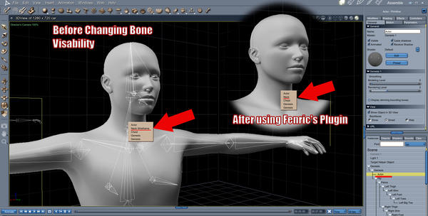

    When you're posing a figure,. there are a couple of things that can help,..
    You can right click over a figure, or body part,. and then select the part you want to focus on , from the right click menu.
    Once you've selected an item,. or part,. then you can hit "0" (zero) to focus the current camera view on that selection.
    Hope it helps :)
    868 x 684 - 121K
    After using Fenric's "Change Bone Visibility" plugin, you're no longer plagued with "Wireframe" selections dominating your right-click menu - so it's easier (a LOT easier) to right-click and get the correct selection.
    As 3dage's image above helps to illustrate, since he right-clicked on the bone of the Left Pinky 3 selection, "Left Pinky 3" does not even appear as an option to select. So to actually select "Left Pinky 3", you must right-click near, but not on, the Left Pinky 3 bone - or whatever you're trying to select. After using Fenric's plugin, this changes significantly - the right-click menu becomes the same as if you were using V4 or M4.
    Nowadays (since buying Fenric's tool) I never go in to pose Genesis without first using the tool.
    In the illustrations below, the first image shows how to apply the Change in Bone Visibility using the plugin. The second image shows the difference it makes in the right-click menu.
    After trying to pose a Genesis 1 or 2 figure without the plugin, it's truly amazing how much more efficient it becomes after using it. You'll never go back.
    1679 x 852 - 774K
    1679 x 1018 - 1M
