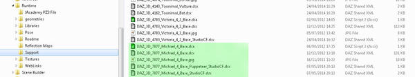

M4 won't load.
ewangrant1ewangrant1 Posts: 0
Message: Cannot find the M4 support folder
I re-imported metadata. No difference.
Went to install manager and uninstalled all M4 listed. Re-installed. Opened up Daz, went to load M4..
Cannot find M4 support folder. May I say wt...?
1291 x 242 - 62K

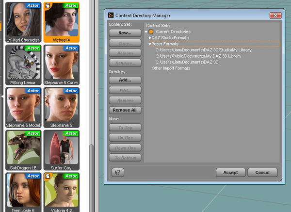

  • JaderailJaderail Posts: 0
    Do you have your content folder set as both a DAZ Studio Format folder AND a Poser Format folder? If not DAZ Studio is not seeing the needed files at all...
    429 x 467 - 62K
    That bottom folder does not need to be listed and it should NOT be used for content. That causes a Nested Content folder as Studio and MyLibrary both are In that main folder. You can not have one content folder inside another folder that holds content except for a Poser style Runtime folder inside a DAZ Studio Content folder.
    You now have Nested folders and that Broke the libraries ability to read the content.

    Removed it again, just added 5 minutes ago to try and find poser content that seems to have been lost. I can assure you that is not the cause of my M4 and V4 issues which pre-exist my latest blunder. :)

    They are the files in your first screen shot, in Runtime:Support
