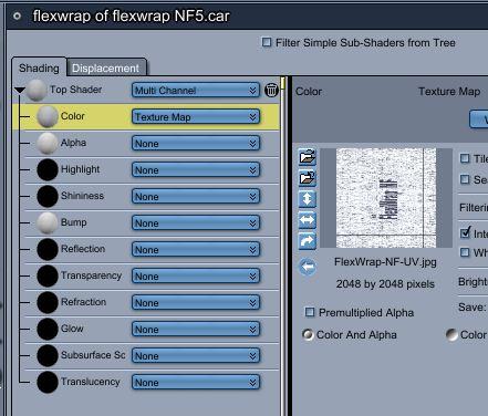

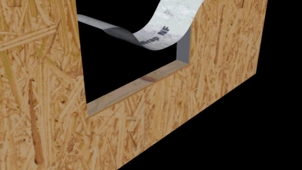

Maybe I'm missing something, but why did you use a layered list for this? I get the attached results using basic Multi Channel top shader.
Thanks for responding. I also changed my shader to the same as yours. Yes, it does work. BUT, the underside of the material needs to be black in color, representing butyl. I thought that a layers list would address this. So, how can I make the underside black without distorting the topside? I really appreciate your feedback!

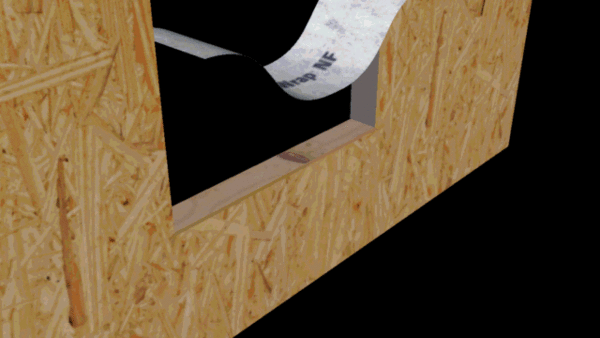

Not sure how you were going to use this animation, but another simple resolution is to duplicate the object and assigned the appropriate shader. I simply offset slightly in z position (took one minute to set up; notice the back is black).
