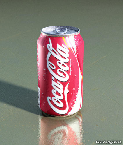

    I now have experience of the online model converter I linked to above.
    I found a simple .lwo model online and downloaded it. Then I uploaded it to the website linked and it was dead easy to convert it to an .obj.
    The only problem being that there is some work that needs doing in Bryce when you import it (The .obj didn't have the UV map on and it didn't ask for it even though the online software did create an .mtl file). This may have been the way the model was set up originally or it may have made a difference if I had also uploaded the .jpg UV file, I don't know.
    Anyway, this is the finished render of the imported .obj model... looks quite good to me.

    @Dave, Oh nice coke can, where did you get it from?
    http://tf3dm.com/3d-model/coke-can-80892.html
    But after conversion it needed a bit of work in Bryce to get it to look OK. :)
    I think it's like most models and it will depend on how it's set up in the first place.
    The converted model was a single mesh but the label artwork that came with the .lwo wasn't set up as a full mesh UV map, so I presume that the original model had separate material zones for the label and for the metal parts.
