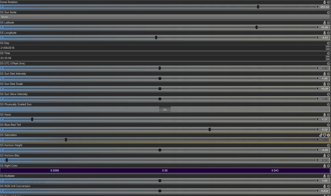

    These are the settings.
    Click on image for full size.
