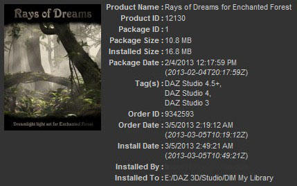

  • LindseyLindsey Posts: 2,017
    edited May 2014
    Odd.. The rain preset loads fine for me. I've attached the DIM installer info.
