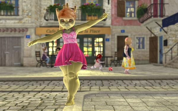

Dear Daz community,
In this picture ( http://sta.sh/0umhvpuites,
a previous version http://yupasama.deviantart.com/art/Lapin-dans-un-village-de-provence-450413818 ), I managed to add a golden halo of light on the fur.
The character uses
- garibaldi hair plugin, surface settings: 0.66 transparency, TT intensity 2, and a yellow tint
- Loyce hair
- uberEnvironment2 light
But in truth, I would like to recreate the effect of bright sun rim light in hair, like in that stock photography : http://wallpaperscraft.com/download/child_girl_lights_locks_sun_49212/2560x1600
Do you think it's possible with polygonal hair like Loyce Hair, or I just need to go full garibaldi ?
Can you give me hint about light or shader or surface settings ?
or is it even possible to do it with Daz and 3Dlight ? :)
thanks for your advices and comments.
1728 x 1080 - 431K

    All that can be done on pretty much any hair type, Bali, LAMH or Conforming and Prop hairs. All it takes is well placed rim lights with good settings. There is no proper way to do it. Whichever method works best for you is the method to use.

    It's not that it can't be done, as Jaderail says. It's that it requires careful placement of a lot of point or spotlights around/behind the head, and it's going to be fiddly and expensive on system requirements unless you can make it look right with shadows turned off on all of them (try that first).

    3Delight does not have "literal" lighting like Luxus or Octane. Rim lights frequently do not do what you think they will do and you have to use additional lights focused on specific areas to get an effect. That's assuming that I correctly understand what "rim light" means in this context (maybe I don't).

    By rim light I meant a strong light behind the subject, but in fact I'm trying to mimic the way low sun light gives an halo around hair, and yes 3Delight does not do that without work.

    DAZ Studio lighting is a very different thing than the real world lighting built into many Apps. The reasons why vary from ease of use to for special effects that can not be done with real lighting. Which makes some things easy I admit and others very hard. But time spent on 3DeLight lighting is something that will pay off. The issue is it only applies to 3DeLight or other Renderman render engines. I have caught myself trying a method for DS in a Luxus Render many times before and then wondering why it did not work.
