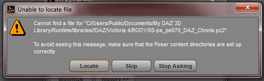

    I moved my content folder directory to an external drive (made sure DIM was installing there and that DS4 content manager was pointing there for both DAZ and Poser content), but now I'm having problems with V4s deltas. Every time I try to apply a morph I get an error because DS4 is still trying to locate the file on the default drive?
    How do I get around this? Have I missed something really obvious? I haven't tried DS3A yet (which is sharing the folders) to see if I get the same problem (but I suspect I'll have the same issue there as well.
    EDIT: Looks like DIM defaulted back to the root drive at some point, so I just reinstalled everything. Hopefully that has fixed it.

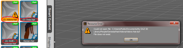

    Fixed one problem, created another. Now I have multiple thumbs for some files and other files (the ones that came with DS4) are now missing completely! I am now also missing V4 elite morphs, even though I had them on my old copy of DS3.
