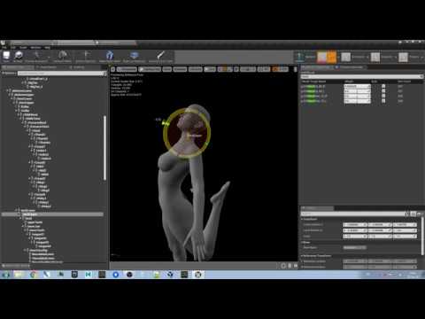

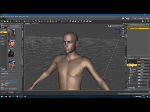

Hello all,
After months of experimenting I think I have finally worked out a way to get rigged high poly characters and morphs out of Daz Studio, into Blender, and ultimatly into your game engine/renderer of choice.
I just put up the first video tutorial on getting things set up.  This is my first real video tutorial. Before I do the next one I would very much like to hear any feedback you might have.
EDIT 1: I changed the title from Solved? to Workaround. High Poly exports aren't solved but this may be a good way around part of that. Plus after a day of thinking about it the original title seamed click baity to me.
EDIT 3: New video link below:
I cut 5 1/2 minutes out and streamlined the process significantly. I also added a brief explanation on why we are scaling down parts of the mesh. Thank you TheKD for the question.
