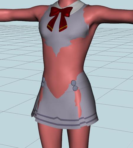

Hello, I downloaded some clothing for A4 from sharecg and tried to autofit them to Genesis figure. However what ever I try, they always won't fit. I also tried to convert them with V4 settings and unsupported, various clothings settings include "none".
What causes that and how can I fix it? Thank you,

    Have you tried selecting Aiko 4 as the original figure? If the clothing was modelled to fit the Aiko 4 shape, rather than the base V4 shape, that would produce the results you see. Which clothing set is this?
  • Member_257874Member_257874 Posts: 76
    I tried with A4 first then tried V4. The problem appears with all clothings of red viper, that one can find at sharecg
  • jestmartjestmart Posts: 4,449
    Could you give a link to the dress? I am thinking it may have been modeled to a morphed body type of A4 not the base A4 shape and that is why auto-fit won't work with it.
  • BejaymacBejaymac Posts: 2,014
    All of the female Gen4 autofit clones use V4's shape, as most clothing was meant to be designed around her shape and then morphed, but not everybody did that, instead they built it around the morphed shape, GND4 and her clothing being one such case, as a result autofit is of no use with clothing like this.
    I think it's one of these:
    http://www.sharecg.com/pf/Redviper2012
    Thanks for the link Kerya. I looked myself but couldn't find that exact outfit. Of the ones I did find and try I am even more convinced this artist simply did not model to the A4 base shape. Some outfits where a close enough fit for Smoothing Modifier to fix but others where way off.
    edited May 2014
    I can't find it myself atm but as said, it happes with all of the clothing even the simple one. The poke through parts are also always the same (at the lower belly part and around the stomach as well as at side torso and shoulders. The vshape you see on the picture you can notice even with the underwear.
    If it was a morph, is it possible to transfer the morph somehow? (Like A4-Stylized or something)
    Post edited by Member_257874 on
