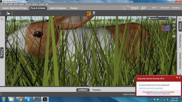

I have been trying for an long time now to stop grass object to appear through an onject or character how can you make the grass not go through any object or character feet

i add an Geometry Shell 1 and added the grass to that but it is still showing through the rabbit

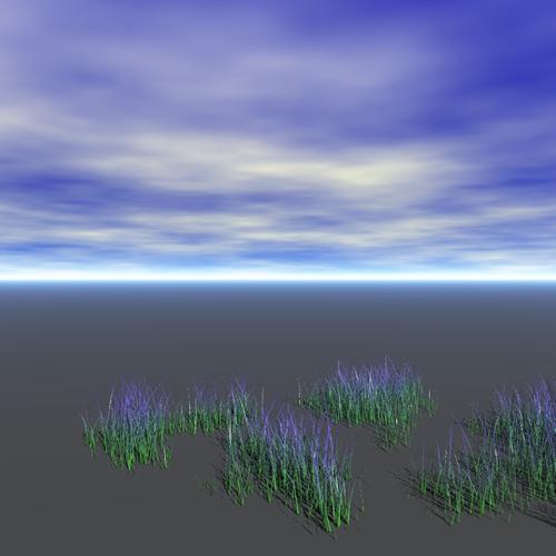

as long as you position the patches to not be under the figure. It is just easier to do it with the patchy bits in this set.
this shows what I mean about patchy bits. Ignore the texture, I was using the grass to simulate patches of bluebells in the distance.

I just did it quick to show you how the grass patches are.
