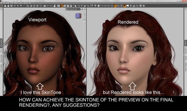

The goal is, I want the Skintone previewed on the Rendering but its came out very opposite.
my first time with this kind of problems on my 8 years of 3D hobbyist career [??]
had this happened to you before and How you fixed it?

  • alexhcowleyalexhcowley Posts: 2,409
    Which option on the surface pane have you changed? The main one that controls the skin tone is the diffuse channel.

    You can try adding a darker grey in the diffuse colour channel for the skin groups to try and match it based on your example. Results from preview will change at render stage because it is calculating the lights in the scene and how it reacts to the characters skin shader.
    Cheers,
    Alex.
    not only the diffuse, the ambient plays an important role too, I'm gonna check both channels...
    Thanks for the tip, going to try your advise too.
    In all my previews and renderings, never got this abrupt change of skin tone, all my works have been almost equal in terms of skin tone between preview panel and final rendering, and, if some change of tone would viewable, the difference is understandable, but not this time.
    that's my jumble and why I'm confused, on past years this would be ok, but not on this time with all my experience, maybe I need to relearn the basics or maybe I'm on the bad mood of "I know all and nobody can teach me more than I know"

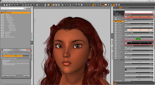

    Thanks for your suggestions!, this was resolved so quickly!
    you two took me to the conclusion that I was doing wrong:
    alexhcowley, the diffuse channel I sense it like OK, but indirectly you took me to check the ambient channel because I knew that is part of the final tone in my universe!, and it was on pure white at 15%, pretty enough for make drastically changes on any surface!
    Zev0, changing the diffuse color on gray led me to another dark skintone, was ok but I need some chocolate skin tone, your tip took me to change not gray, but terra/brownish colors on the diffuse channel, and voila!, here is the results!
    THANKS A LOT! :coolsmirk:

  • Zev0Zev0 Posts: 7,123
    edited May 2014
    Cool:) I always use a darker grey just to get the right brightness level, then add a slight colour into that if it's still not right, which you have done:) Glad you got the results you wanted:)
