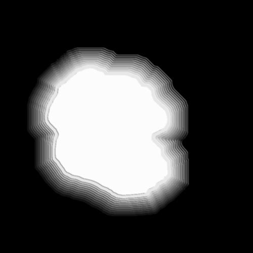

    Are we talking about something along this line. Sorry, this is not a great example as I just slapped this together. But I created the primary flat topped mountain in Paint Shop Pro. Depending on type of graphics program you have access to, if you can just create an image ( I did this as 800 x 800 and original pure black ) I then took a selection tool and in center created area I wanted as the top flat area and filled it with pure white.

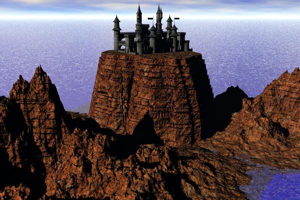

    I was then able to expand the select area about 5-10 pixels at a time and each time I would slightly lighten the selected area so you have various shades of gray expanding from light to dark which created my mountain. (See image below) In Bryce, I created a terrain mountain and then used the terrain lab to replace the mountain Bryce created by using the picture of the mountain I created. Once back in Bryce main work area I edited the mountain using the scale tool to adjust height and width as I needed and assigned a material to it.
    Once the main mountain was as I wanted it, I created some more mountains around it and assigned the same materials to them as well as changing the ground plane to water. To finish it off, I added the castle I exported as an object file from DAZ Studio and sized it to fit on top of the flat topped mountain.
    Now this was just a quick and dirty way to do this and you should still check out the video that Guss mentioned to probably get a better idea on how to do this properly. Such as if I had spent more time on my example, I would have tried to create some type of road into the side of the mountain (People have to get to the castle somehow)

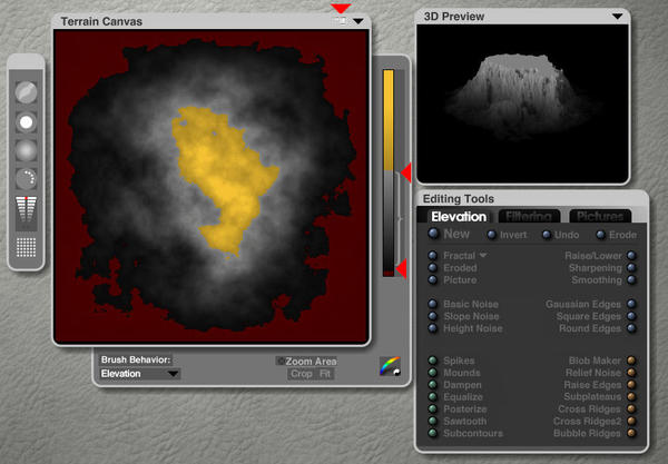

    @edifex - easiest way is to create your terrain in the Terrain Editor (TE), then cut the top with the bracket. You open that part right of the Canvas by clicking on the thumbnail on top right. Then you can grab the top (or bottom) of the braces and move it down (or up). The part that gets yellow will be flat on top (and the part becoming red cuts the lower part of the terrain for islands). You can also grab the bracket and move it up and down. The preview shows how it looks.

    @edifex - Just a small detail I forgot to mention: the terrain must be set to solid, otherwise you get a hole. Can be handy for a volcano. The preview in the TE doesn't show the difference.
