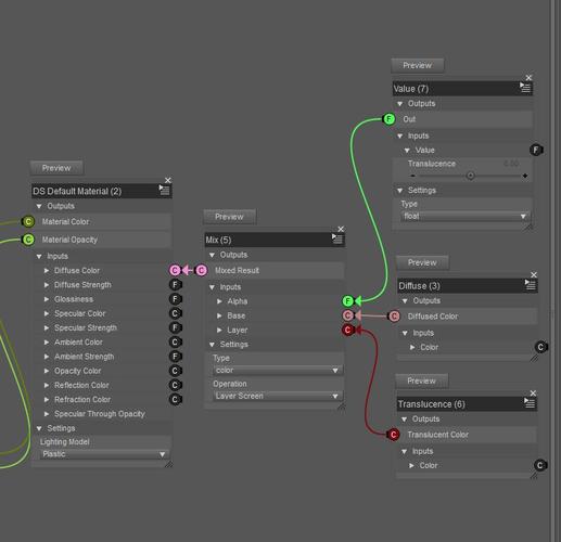

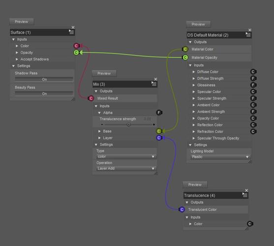

    Are you trying something like this? With Screen or Add.
    782 x 756 - 57K

  • Richard HaseltineRichard Haseltine Posts: 111,363
    Just feed your current diffuse settings in where I'm feeding the Diffuse brick in above and it should be fine.
    It does work for me - to the extent that there's light on the facing surface of the item. That clearly isn't how one would expect translucence to work, but I'm not immediately seeing where to go next.

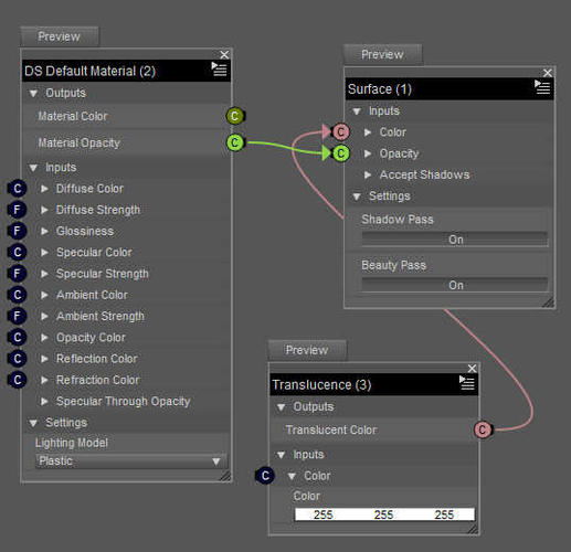

    OK, I was getting muddled - you need to combine the colour output from the DAZ Material brick with the colour output from the Translucence brick and then feed that into the colour input of the root brick - then it does work (I thought I'd tried that initially, but I did keep adding another Diffuse when I wanted Translucent so that may have been the problem)..
  • IceEmpressIceEmpress Posts: 639
    Wait, what is the DAZ Material brick and the root brick?

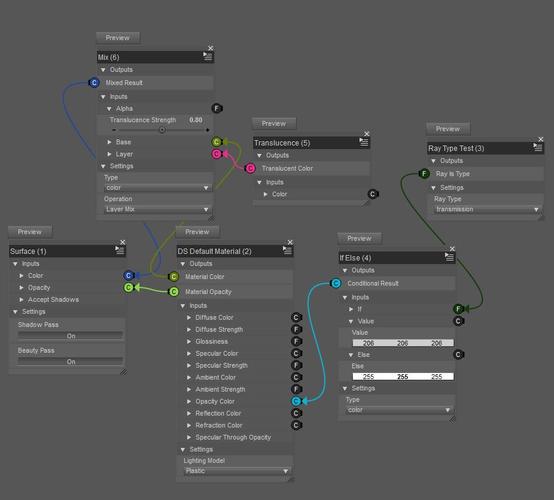

    edited May 2014
    Default Material in my screen shot is what I meant - you should take the output from that and combine it with the output of the Translucence brick, then plug the result into the final brick that is currently receiving colour (and Opacity, which you leave alone - at least assuming that the surface is essentially opaque) from the Default Material.
    826 x 741 - 51K

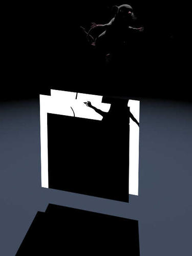

    edited May 2014
    You do have a light casting a shadow of the item onto the back of the translucent surface? With a shadow casting distant light shining from behind the figure and the above network applied to a plane infront of the figure, Translucence Strength set to .6, I get this:
    1000 x 1000 - 188K
    What are you expecting it to do? Translucence is being able to see the effect of light shining on the other side of an object, like the screen in a shadow play, so yes you need a light (probably a shadow-casting light) in the scene. if you want an item to be partially see-through just lower the opacity.
    Not being ignored by me, I was just in bed.
    I'm still not sure what you mean - in order to have a shadow you have to have a shadow-casting light, and if you do (as my render shows) you will see the shadow of the object behind the opaque surface cast onto the surface (or more accurately you will see the light on the back of the object where it isn't being shadowed).

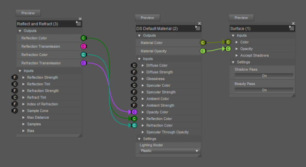

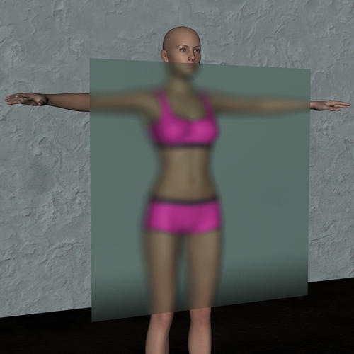

  • CzexanaCzexana Posts: 167
    If it's not the translucency effect that Richard showed, is it a sort of frosted glass effect you're trying to get? Where you see a blurred image of objects behind the 'translucent' surface?
    Here's a very quick one I did using the 'Reflect and Refract' brick to get blurred refraction ... I'm not sure if I got the connections right.
    848 x 848 - 93K
    913 x 501 - 61K
    Yes, I've used the sample cone setting to get the effect of frosted glass, with the blur increasing with distance. I also used a dots (?) pattern brick to give it clearer parts, like the glass used in doors sometimes.

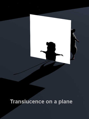

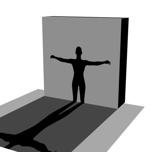

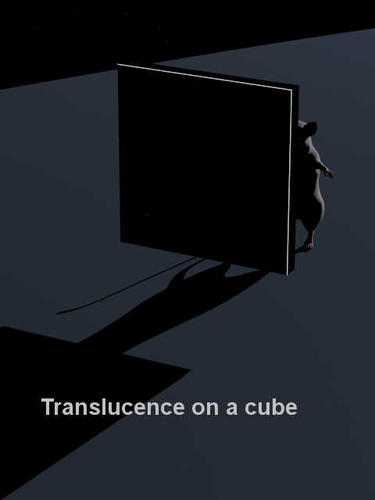

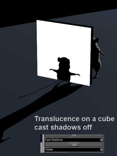

    Some tests with translucence.
    480 x 640 - 16K
    480 x 640 - 11K
    480 x 640 - 12K
    537 x 519 - 24K

    Wait, what? I thought it made a silhouette of other objects behind said object visible. So what the UbS shader's translucence does is creates a cast shadow projection through the surface? That doesn't seem very realistic...
  • KlasKlas Posts: 18
    Here is a nice example: http://www.neilblevins.com/cg_education/translucency/translucency.htm
    The problem is that the cube and so on are not single solids as far as the render is concerned but just two (or however many) planes. You see the light falling on the back of a surface, but with the cube or the two planes or your spheres you need light to pass through the back surface so that it can then cast a shadow on the front surface. You need to lower the opacity for that to happen, either across the shader with the global opacity control or by turning cast shadows off or, a trick I have used, by using a ray test brick in Shader Mixer to make the surface less opaque to shadows than it is to other rays so that light can pass through but you can't see through, as with many real-world substances (for example, most lamp shades let a fair bit of light through without enabling you to see the bulb or supports inside the light -something that's not really possible with the basic shaders in DS/Poser). I don't know if this is going in the direction you want:
    1000 x 1000 - 162K
    926 x 835 - 68K
