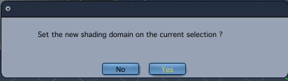

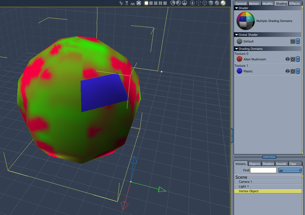

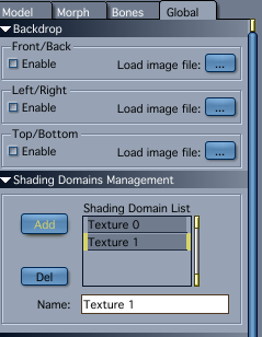

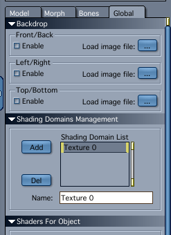

    What you do is open your object in the Vertex modeler, select the polygon that you want to have a different shading domain, then click the Global Tab as in my screen shot. Click the Add button and Carrara will ask if you want to apply a new shading domain to the selected area or something like that. Click Okay. In my example I now have two domains. In the text field below the domains you can change the name to whatever you want.
    Back in the Assembly room view, if you select your model and then the model's Shading Tab, you should see a list of all the domains you have applied to the model. Just put different shaders in each slot if you want. You can also save all the shaders in their proper domains for later use by dragging and dropping the multi-colored ball icon at the top of the domain list to your Shader Browser.

    When you make any object,. it's automatically assigned a default "shading domain" (Texture 0) "you can change that name in the Global tab if you want to"
    If you want to have a area of your object, which has a different texture, then you need to create another "Shading domain" and assign it to the area of your model which you want to be coloured or textured differently.,
    This process of creating a shading "domain"only creates an "empty" shading area on your model,.
    It has nothing to do with whatever texture maps, or shader colours you want to apply to that domain.
    it only creates the shading domain.
    To create the "Shader", (colours or images) you must go back to the Assembly room, or Shader room, and create a "New" shader,, which you can then add any image maps to.
    It sounds like you're selecting the "Choose a "Pre-set" shader" option, which will give you a panel (Scene Wizard) where you can browse the existing shaders that come with Carrara.
    If you want to add your own images, then that's not what you want to do.
    You should click on the little blue button (on the right) to select a shader, then scroll down to the bottom of the list, and choose..
    .(New Master Shader)
    this will create a new shader, where you an add your images, or colours.

    >>> Adding a new shader (for single polygon), check. I couldn't follow the above as I saw no blue button to the right... That's in assembly mode?
    Yeah, a little craft.... where one polygon gets a map of two little windows or something like that.
    Thanks for your time.
