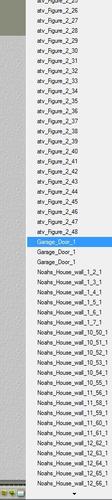

Question:
I've imported an obj file with hundreds/thousands of sub-mesh parts. It looks/works fine. When trying to directly select meshes using the bottom-of-the-screen selection menu (see attached, if it works), to apply Bryce materials, I get a mesh selection menu that goes off screen in both directions... This can't be a new problem, but perhaps someone has a trick for scrolling/tabbing/paging through this list?
FWIW, I'm aware of the magic "ctrl-click" on an item to select it's meshes/sub-meshes, and use it often, but would like to 'browse' that mesh list sometimes for hints/conventions used in an objects names, etc.

  • HoroHoro Posts: 11,730
    @mindsong - for me it works to move the mouse below the screen to scroll down to the end.

  • GussNemoGussNemo Posts: 1,855
    I just went through this very thing with three models I created in Sketchup. When I imported them into Bryce, opening up the Mesh window, there was a small down arrow at the bottom of that window. And when I reached the end of the list, an up arrow at the top of the screen. The largest model had 52 meshes.
  • mindsongmindsong Posts: 1,788
    bingo. Dual monitor issue. I don't see the top/bottom ends with both monitors enabled!
    Disable the second monitor, and there are the expected/described controls.
    I've never had need, nor, have I ever run Bryce on another system where I would have known to look for these scrollers/'select all meshes' end-points.
