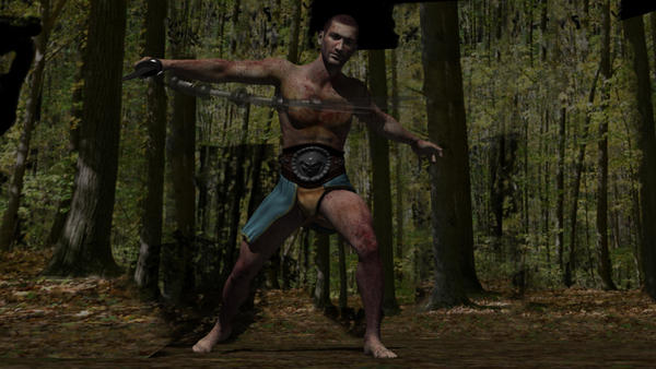

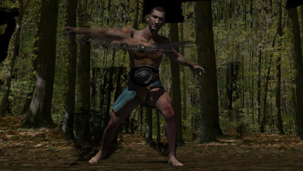

    Ok--here are two tries at the still image version. I think I need to tweak some of the layers, but I kind of understand what I'm trying to do. I'm going to try some of your ideas with animation tomorrow. Thanks to everyone for helping! (Please ignore the lighting and set-up..this was a quick and dirty test :-) )
