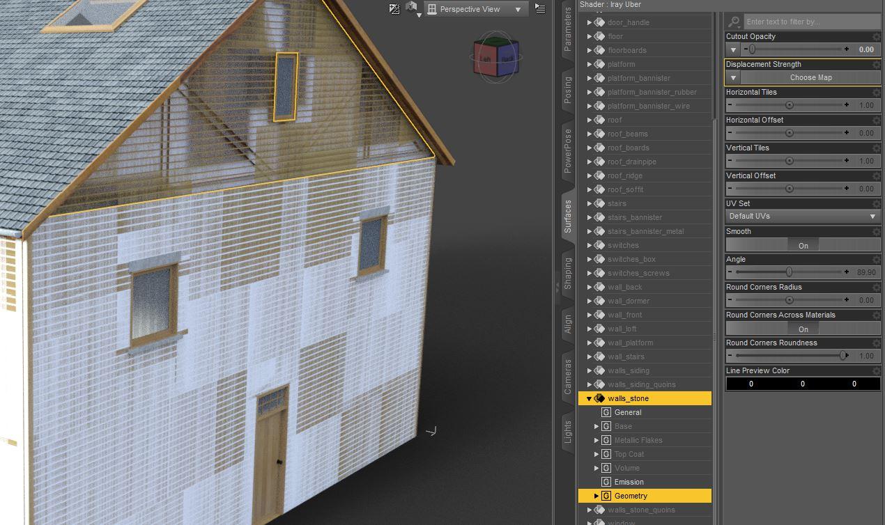

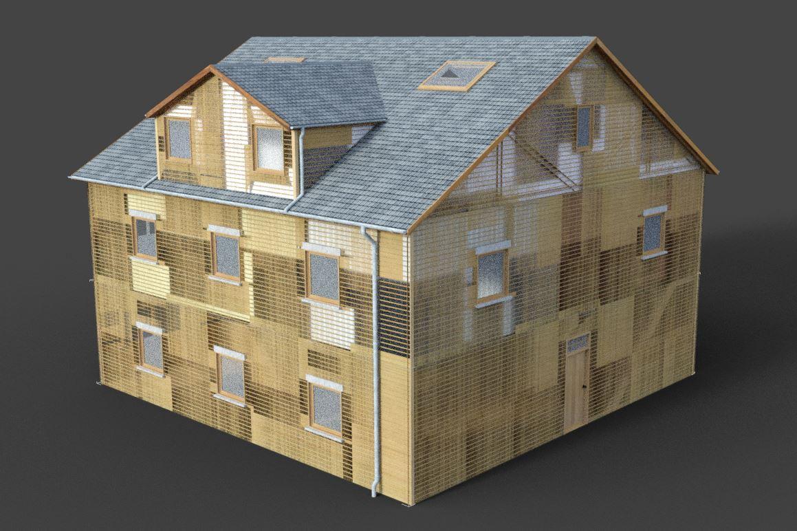

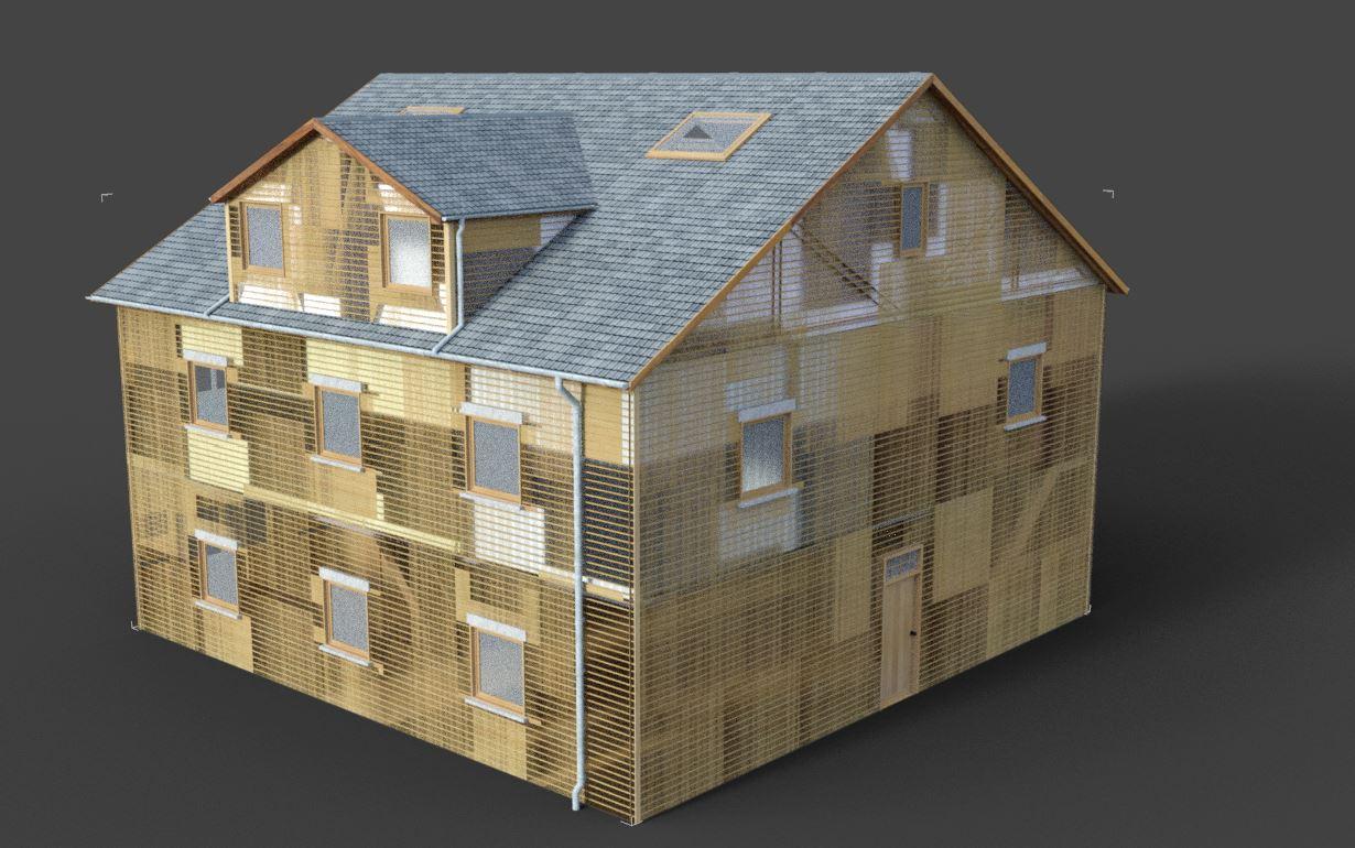

I did managed (finally!) to buy the Home One House and... I try to convert it to Iray to save it as Preset (and maybe I can offer the Scene subset then in the Freebies), BUT...
The iray Preview does show a brutal broken Tiling of the House Structure, it seems to be fine inside (first attachment), but outside not.
Update, during writing: I just see that the surfaces have a wall_stones with a opacity with 0..., no idea what that plan is. image
See attachments.

with iray Uber Base:
Original loaded from Poser Lib:
The right bottom corner looks different... I dont see much differences :/

    The problem here is that Home One was released before Iray was ever heard of and it's designed to work in 3Delight. It *can* work in Iray, but you may not want the hassle. If not, DAZ will give you a refund, no problem. Here how it can be made to work for Iray.
    1. Load the figure you're using (or select it in the scene), select all the materials, and convert the surfaces to Iray (Apply the Iray Uber shader holding down CTRL and choose Ignore maps to keep the existing textures)
    2. Go to Menu> Tools> Geometry Editor (ALT+SHIFT+G), then open the Tool Settings pane.
    3. You'll see 2 expanded lists - Face Groups and Surfaces. The Surfaces list is in alphabetical order, so the first 7 entries are for the outer wall. So, suppose you want to use '2exterior_stone', click on the eye icon for the other 6 surfaces to make them invisible. In other words, leave the surface you're using visible, and switch off all the others.
    Here's a quick test render I did following the steps above. Let me know how it goes.
