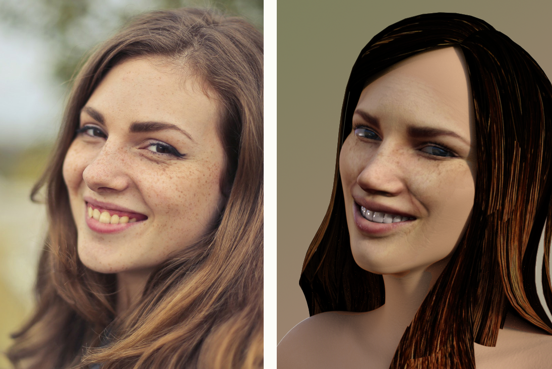

Here is a schematic of these challenges (Picture 2):
Any “Photo-to-3D Head” software thus needs to perform a few additional tasks if it wants to succeed:
1. Establish rotation angle/degree and direction, create a new and uniform shape and then rotate the 3D mesh back to frontal. 2. Also detect if a photo represents close lips or an open smile. The method to do so is to deploy an automatic “facial feature detection” algorithm that find several dozen significant points in a photo that represent eyes, nose, mouth, etc. By comparing these point sets the software needs to “decide” if there is an open smile present or not.
Once the 3D head is rotated back to frontal with the corrected shape, the texture mapping can take place. This represents a further challenge; Since part of the texture is turned away and not visible, a method needs to be found to replace or repair missing texture.

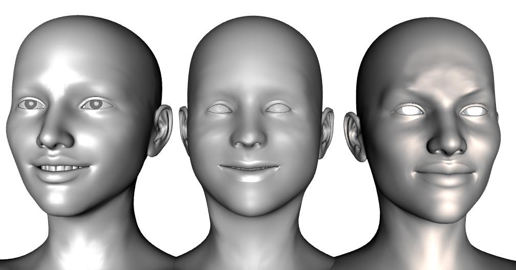

Compare Results of Shaping Heads based on a Difficult Photo.
Below you can observe three samples on how the various software performed with the same photo. As is obvious, they achieved various degrees of success in capturing the shape of the head.
The first head on the left captured both the shape of the head and the open smile well. The head on the middle did a poor job in capturing the shape but recognized the open smile. The head on the right did a good job in recreating the shape of the head but was not built to recognize or display an open smile with teeth showing (see Picture 3 below).
