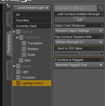

  • Richard HaseltineRichard Haseltine Posts: 111,647
    edited April 2014
    If by glow you mean emit light, use the ubeArea shader. The Advanced Ambient, Advanced Spot and so on lights by Age of Armor suport a degree of linking - you need to give the surfaces you want to target a unique value in a property (say 99% Diffuse Sttrength instead of 100%) and then set the light to illuminate only surfaces with the specified property value.

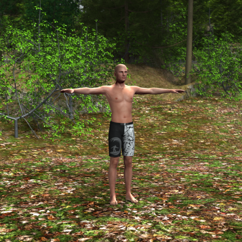

    So here's my set so far except that, since it is a full 360 degree wrap around, you don't get to see much yet.
