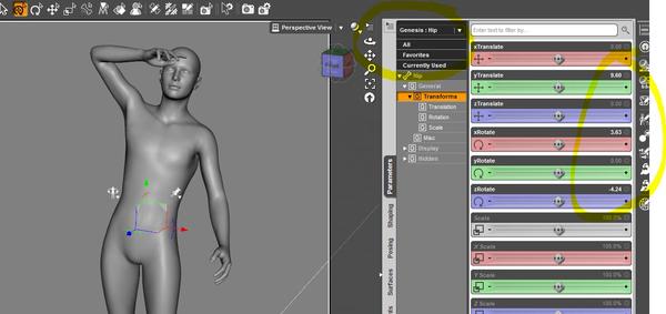

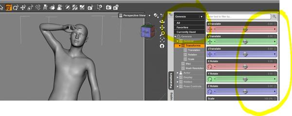

    As far as I know the only way you can have x,y,z at zero on root and yet still have a figure rotated or lying down etc is via the hip x,y,z. as shown in these images.......perhaps a screen shot or two of what you are seeing would be helpful.......when I select the Hip on Genesis I don't see Bend Twist etc. so perhaps you are selecting something other than the Hip node?

    Okay, Aave, I feel a little stupid admitting it, but you've identified the problem, and now I feel the refreshing breeze of understanding.
    Yes, in fact, previously it seems I have always been selecting the Pelvis. Is it possible to select the Hip via Node Selection? Because I'm finding (now that I'm trying) that I can only get the Hip via the Scene tab. The extra layer of obscurity is what was keeping me from properly assessing its values before.
    And, in fact, now that I AM selecting the Hip, I'm finding all the crazy values that I was looking for - zeroing them now aims the figure toward the camera, and of course in an "upright" way, which is exactly what I've often been needing to do.
    Most of all, this is reassuring because now if I ever want to share poses (or AniBlocks), I can now feel reasonably sure that I will be doing so in a compatible way with the prevailing wisdom.
    Thank you so much, and sorry if I vexed anyone with my ignorance. The other minor lesson of this that I'm curious about is the question above: are you guys selecting the Hip somehow without using the Scene tab? Because exactly my inability to do so is what had led me to such confusion. (I had even known, in theory, that Rotating or Translating the Hip was supposed to work as it turns out, and had been confused at my inability to do so. So I'd been doing such to the whole figure instead, which surely led to my conflicts with settings that I had not even detected.)
