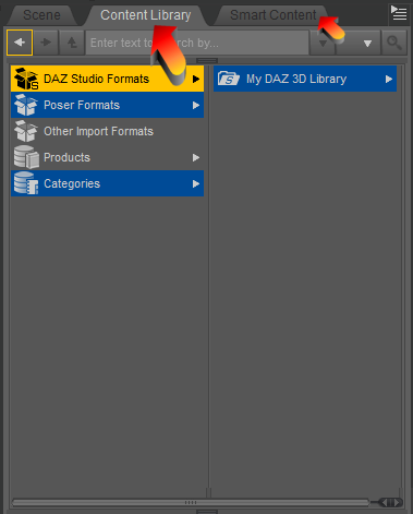

  • fixmypcmikefixmypcmike Posts: 19,718
    There's definitely something wrong with your content folder setup if you are seeing .obj files and not seeing Poser-format files. Can you go to Edit > Preferences > Content Library > Content Directory Manager in DS4, expand the DS-formats and Poser-formats, and post a screenshot?

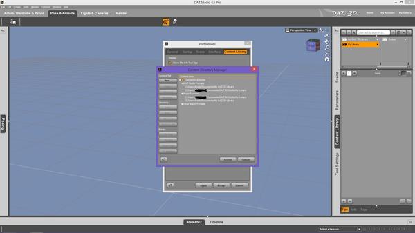

    Here it is.
    Well darn, I can't get the link to work.

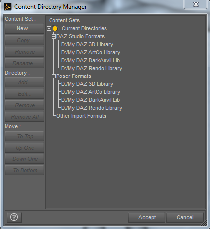

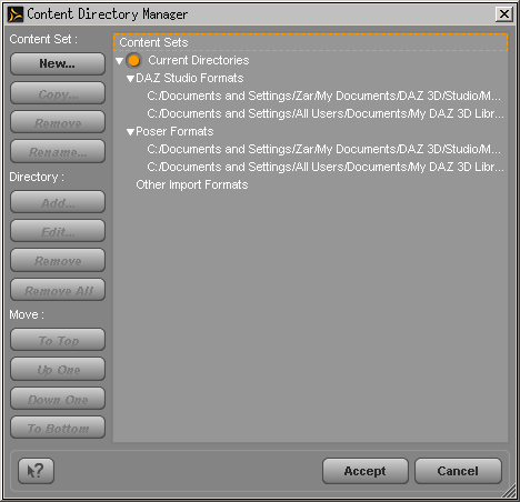

    edited April 2014
    Been there. Hope this helps... fixmypcmike
    sometimes it takes some time for there servers to ketch up to what your doing. It's not just the image hosting sites that can have a link-Live from upload time delay. All three links worked fine from outside the local firewall here, quite some time after your post. ralph100100
    1920 x 1080 - 257K
    edited April 2014
    Seeing as this computer is done with another horrid Spice Sim....
    The paths in my computer don't look that different from yours. One 'Global one' (All Users), and a specific user name one. For each of the Daz root tree things.
    What's the path to one of the items that isn't showing up?
    Is there a folder named "Content" inside "My Library" or "My DAZ 3D Library"?
  • ralph100100ralph100100 Posts: 0
    If your asking about the item that I have scratched over its just my name.
    There is not a folder named "Content" inside "My Library" or "My DAZ 3D Library".
    What's the full path, e.g. C:\Documents and Settings\All Users\Documents\My DAZ 3D Library\Runtime\Libraries\Characters\whatever.cr2?
    That is the full path. Its the same as the photo.
