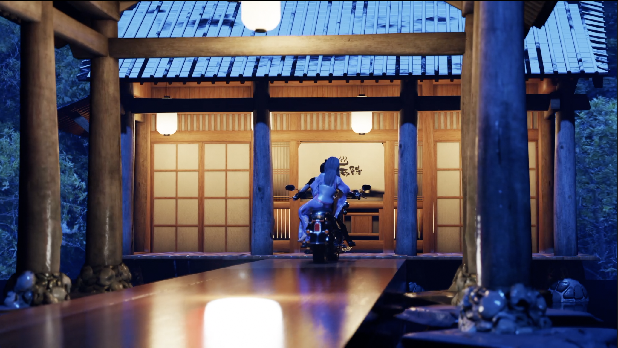

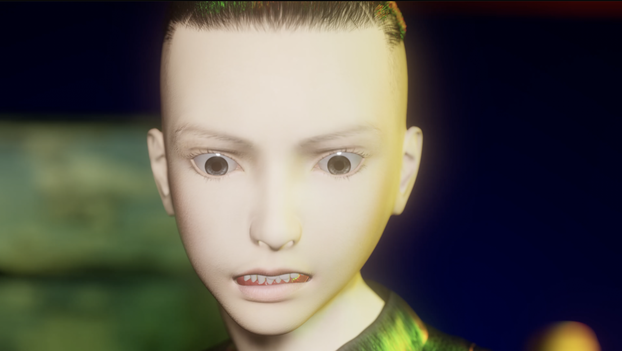

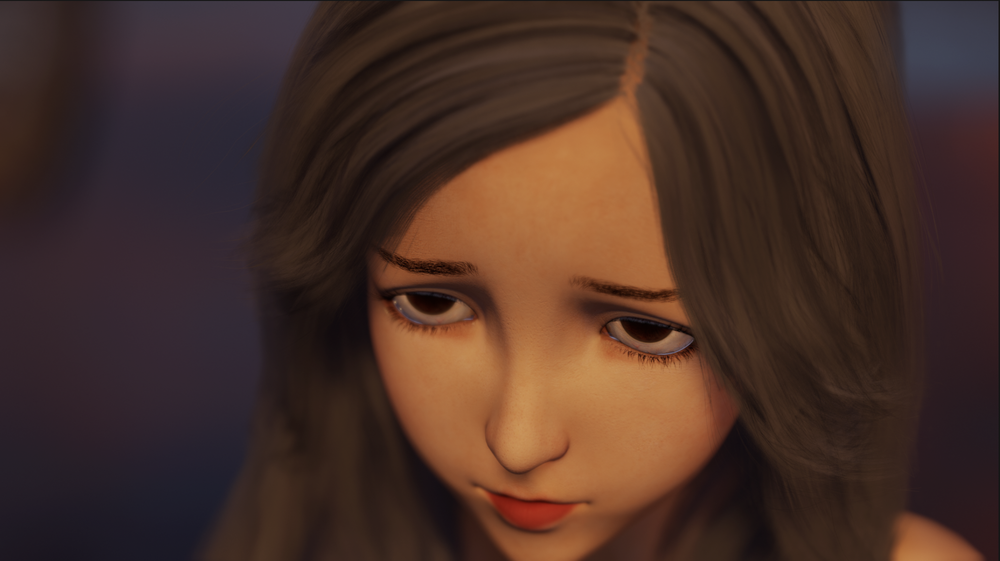

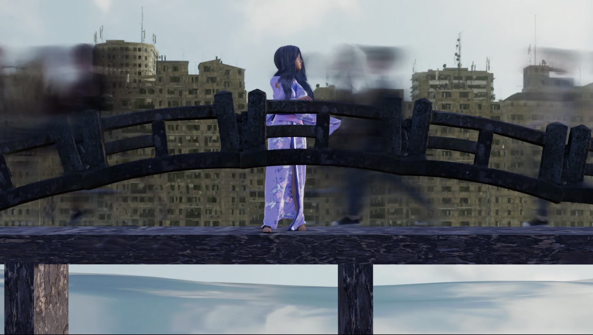

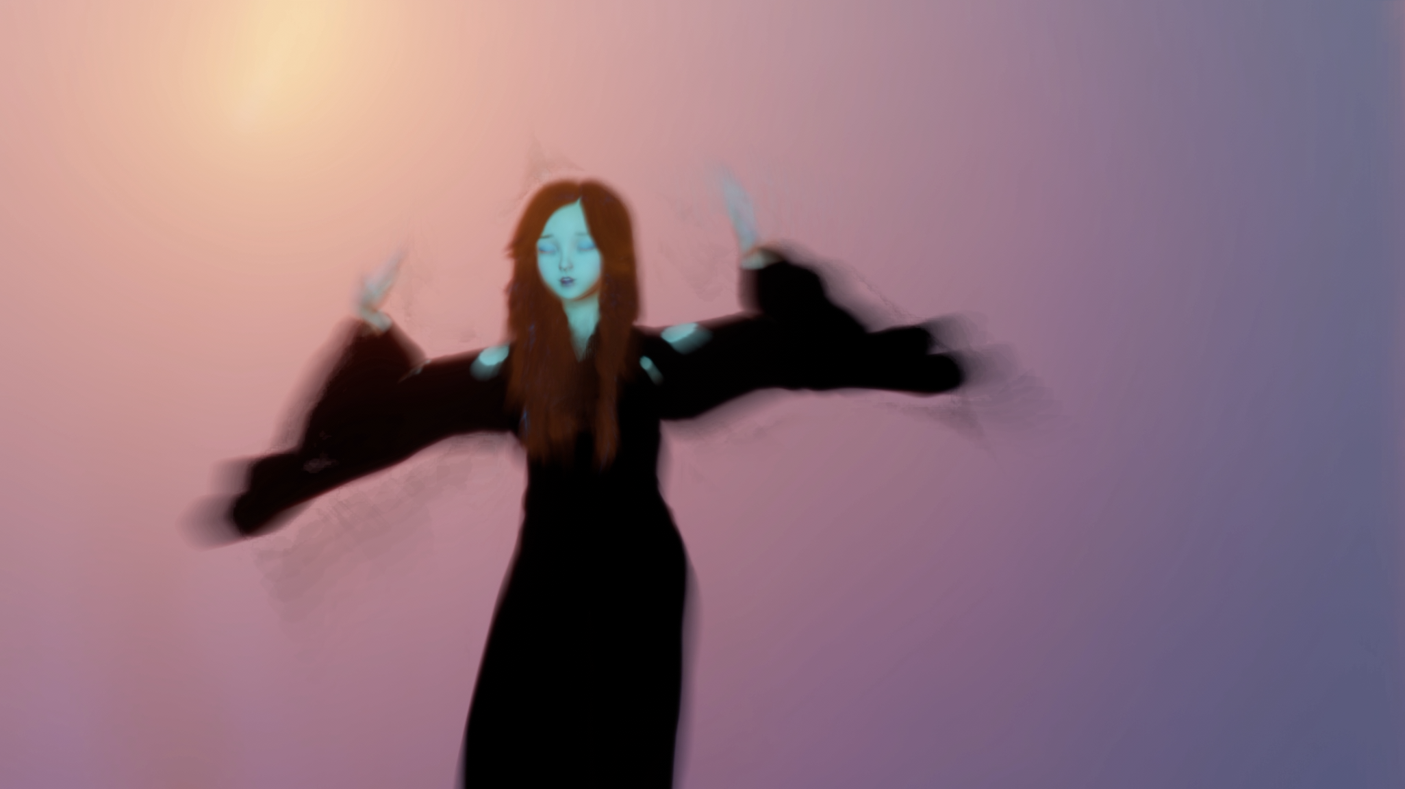

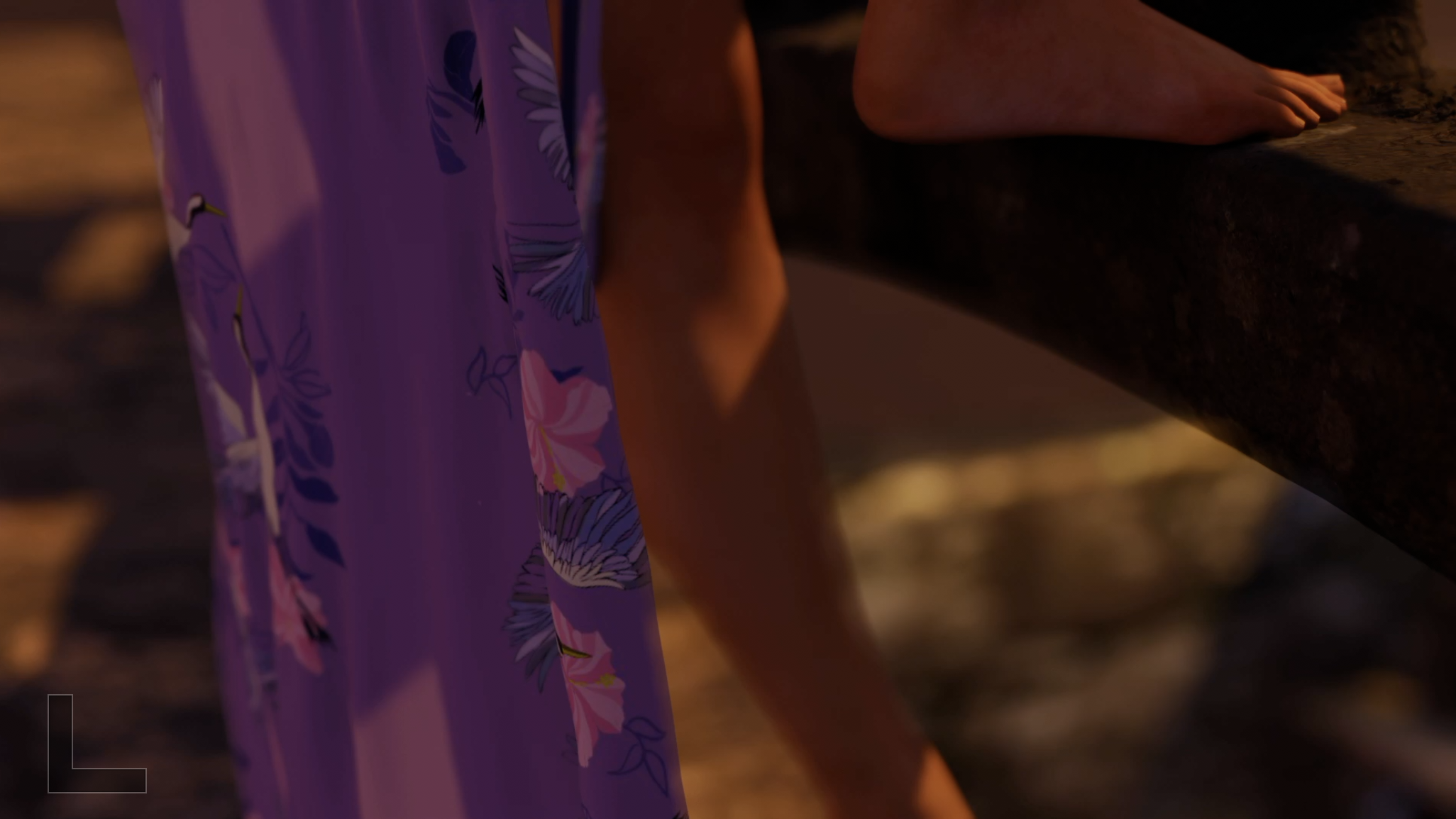

    I've been using Blender now for the past couple of months and I'm in love with it and Daz assets are surprisingly super easy to transfer over and use, and they look amazing. I've been animating in Daz for the past like three years now and it took me at most two hours or so to figure out Blender once I got a character in with the diffeomorphic tool. I started an animated film in the beginning of April and I've already got about eight minutes animated and rendered out thanks to Eevee being near real-time rendering. I'd be done but I did a time-lapse shot that spanned like six three centuries and had to render out about 50 characters walking across a bridge and then layer them over and over in After Effects, there was something like 260 layers lol, it took a week to do but totally worth it. I'm putting some screen grabs here so you can see how Daz characters and environments look in Blender. You can also use Mixamo files with the diffeomorphic BVH Importer.
    The animation itself looks so smooth. You can put rigify on the character through the importer and with that, you can move the torso around and the hands and feet don't move, so you can really have control of the limbs. There's no more feet sliding if you hand keyframe things. I used a Mixamo file for one walk up a stairway and there's sliding from that and I might go back and just keyframe it by hand. Plus with rigify, if a part of the body is moving unnatural, the bone bends backwards so you have to then adjust the hip or torso so that it would be correct and you have realistic looking poses. I love it.
    I also got the cloth sim to work, so you can basically do DForce with whatever they're wearing and you can set it up to do that with hair.
    And you can bring environments into Blender via the diffeomorphic tool as well.
    If you take the time to try and learn it and have any questions, please don't hesitate to ask! The parts of importing the assets into Blender will probably be the part that holds you up the most if you already understand the basics of animation, the importing is what took me about a week to truly get the hanng of, so just let me know and I'll be happy to try and help and make the process quicker for you!
    The TCB falloff sounds like a wonderful tool that I never about! I'm going to have to look at that when I open up Daz next.
