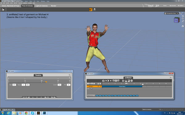

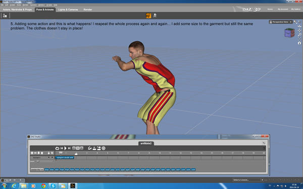

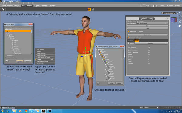

It doesn´t matter how I try, the clothes mentioned like Dynamic doesn´t fit at all when I start to move my character. It seems more like a static joke to me! What am I possibly doing wrong here? I you have experience in this area and know how to fix this problem please reply before I take my straight-jacket on!

DAZ Studio has two timelines, animate and its own timeline. You need to transfer your keyframes to DAZ Studio timeline by right clicking on the animate timeline and select "Bake frames to DAZ Studio timeline". After that's done DAZ dynamics can read your keyframes and you can run your simulation.
Enabling IK, scaling the clothes or parenting to the hip are steps you don't need to do, just make sure that your clothes are "fit to" Michael 4 in the parameters tab.
That's where the problem is — dynamic cloth draped on a character is set for the character in that pose. When you move the character into another pose, whether using the parameter dials or running an animation, the dynamic cloth resets itself and must be draped again.
The way to use dynamics in an animation is not in Animate2, you have to set up an Animated Drape in the Dynamic Clothing tab. The usual method is to use the default 30-frame sequence, starting from the zero T-pose in the first frame to the pose you want in about frame 27. This is a dynamic cloth function, not an animation function, so you do not need the Animate2 tab once the pose keyframes are set.
Ignoring the dynamic clothes, check that the animated pose does what you want, then bring the timeline back to the first frame.
In the Dynamic Clothing tab, click on the "Animated" button, then click on the "Drape" button. The animation will run, draping the cloth at each frame until frame 27, then over the last few frames the cloth will settle.
Note that the dynamic cloth must be selected before you start the drape.
