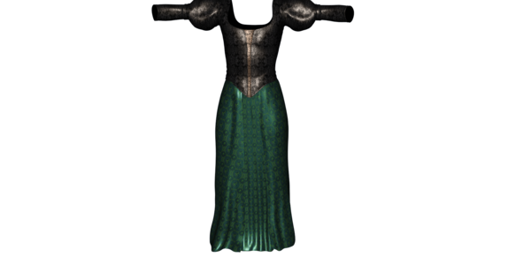

I have a probably not so odd issue with Silkessence. I am attempting to use the over lay and it will over lap and look great but then I render it and its looping. I'm just wondering what setting I need to adjust to make image 1 look like image 2. As always guys thanks for your advice and help.
This is how it looks after render.
1832 x 917 - 497K

    This is how it looks before rendering. Very cool and i like it.
    508 x 771 - 745K

    That is a Known issue in the DAZ Studio Version DS 4.6.2.120. The New Beta version has fixed the TLDmake loop error. I have tested it, the Beta, as I also had that error. I can say that so far I have had no problems with DAZ Studio Public Build v4.6.3.29. I will point out that I have not tested all the new functions but so far my old files that use Overlays do work. I use Overlays such as Shaders and other overlays extensively in my work and the Loop error had stopped me from doing my full type rendering. I'm very happy the error was fixed.

    I don't think that's the looping that was meant - looking at the before and after images, I think you want to adjust the number of tiles (repeats) horizontally and vertically, so that you don't get multiple copies of the pattern (though I'm not sure how well the resolution of the pattern will hold up to rendering without repeats).

    Cool thank but that also brought up a new question how do you limit tiling? Also other question I I'm trying to insert a basic plain but want to use the material from backgrounds made easy on it is there a way to do that I tried just adding the image to it but it get this tiny square. If you want an image i can post one,

    In the Surface pane select the surface you want to adjust (or use the Surface Selection tool to click in the viewport) then adjust the Horizontal tiles and Vertical tiles settings.
