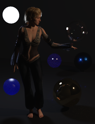

  • Ghosty12Ghosty12 Posts: 2,093
    Well did a test with this setting on and well the picture will show what it does.. The settings here were 200 meters and 50% brightness with the colours both being a dark grey.. If the brightness is set any brighter it washes out the image a lot..

  • DaventakiDaventaki Posts: 1,624
    Thank you everyone who has replied.  I will play with it further and see what happens. Might start out with Ghosty12's settings and go from there.  Need to do some experiments maybe to see if it renders faster than fog planes (although unless I can get a differnet look from the hazy I will probably stick wiht planes at this point).

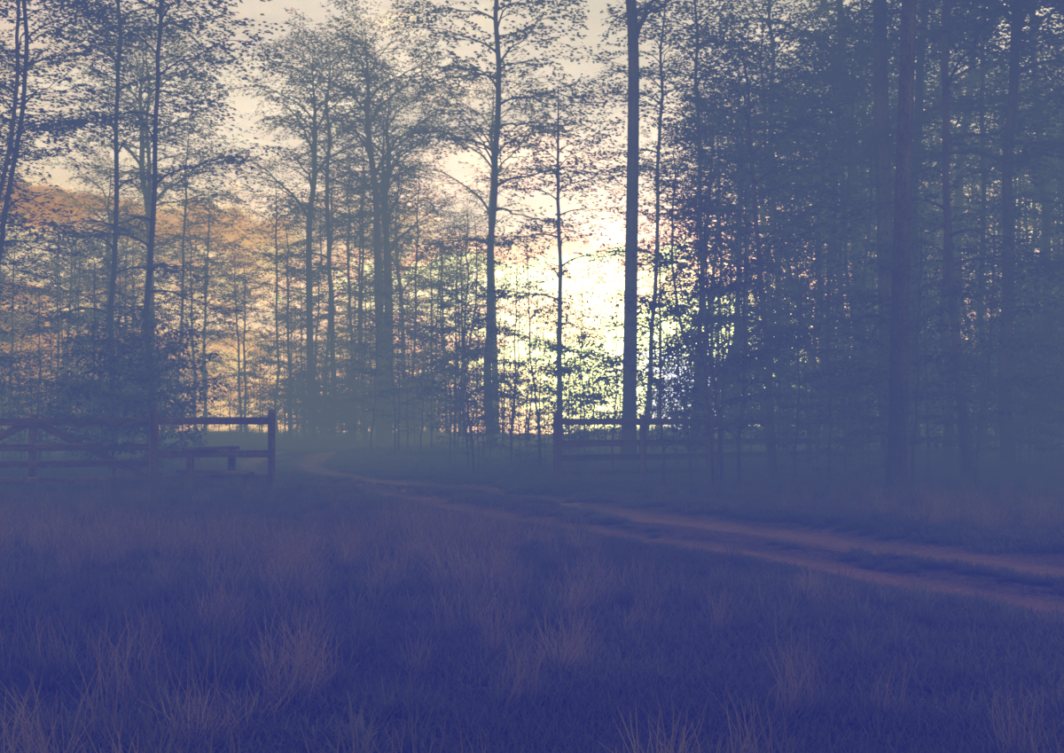

    OK finally getting something and its much quicker than most atmospherics, this took about 6 minutes and went to 500 interations but looks a lot cleaner than if I used one of the atmosphere sets I have. ​No post work

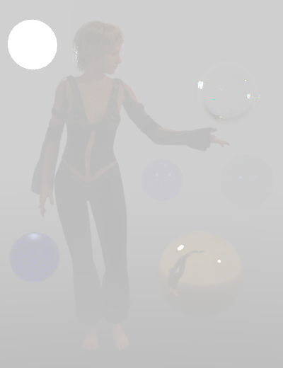

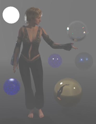

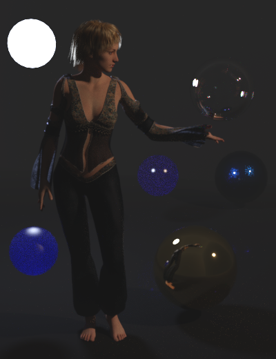

    These forums are weird.
    400 x 520 - 71K
    400 x 520 - 138K
    400 x 520 - 153K
    400 x 520 - 174K

    Interesting stuff.  So turns out that the thicker the fog, the fewer the iterations and faster the render.  I ran a quick test with Sickleyield's old Iray test render scene and here's what I got with a 1070.  Daz Public 4.12.1.117.  All Matte Fog settings except Visibility left at defaults.
    10000m (Default) - 3743 iterations, 3.038s init, 146.158s render
    1000m - 2443 iterations, 3.063s init, 95.622s render
    100m  - 476 iterations, 3.065s init, 18.802s render
    10m - 131 iterations, 3.070s init, 5.079s render
    For comparison, without fog, this is a 167 second render on my machine.
    So there's a big reduction in detail, and you won't get any wispy goodness like you would with a plane prop, but it's kind of cool.

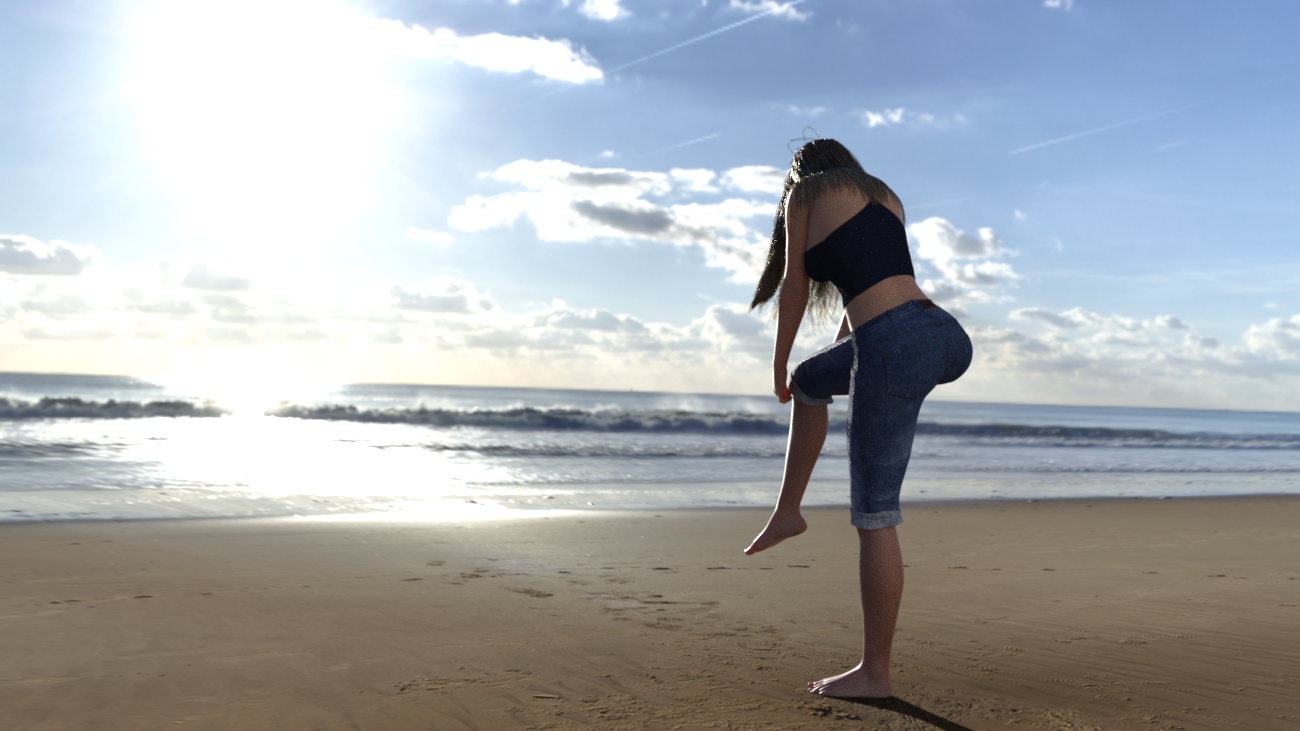

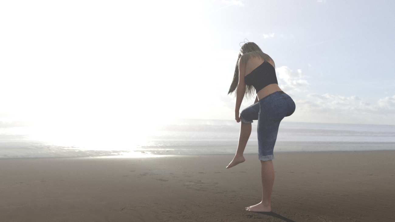

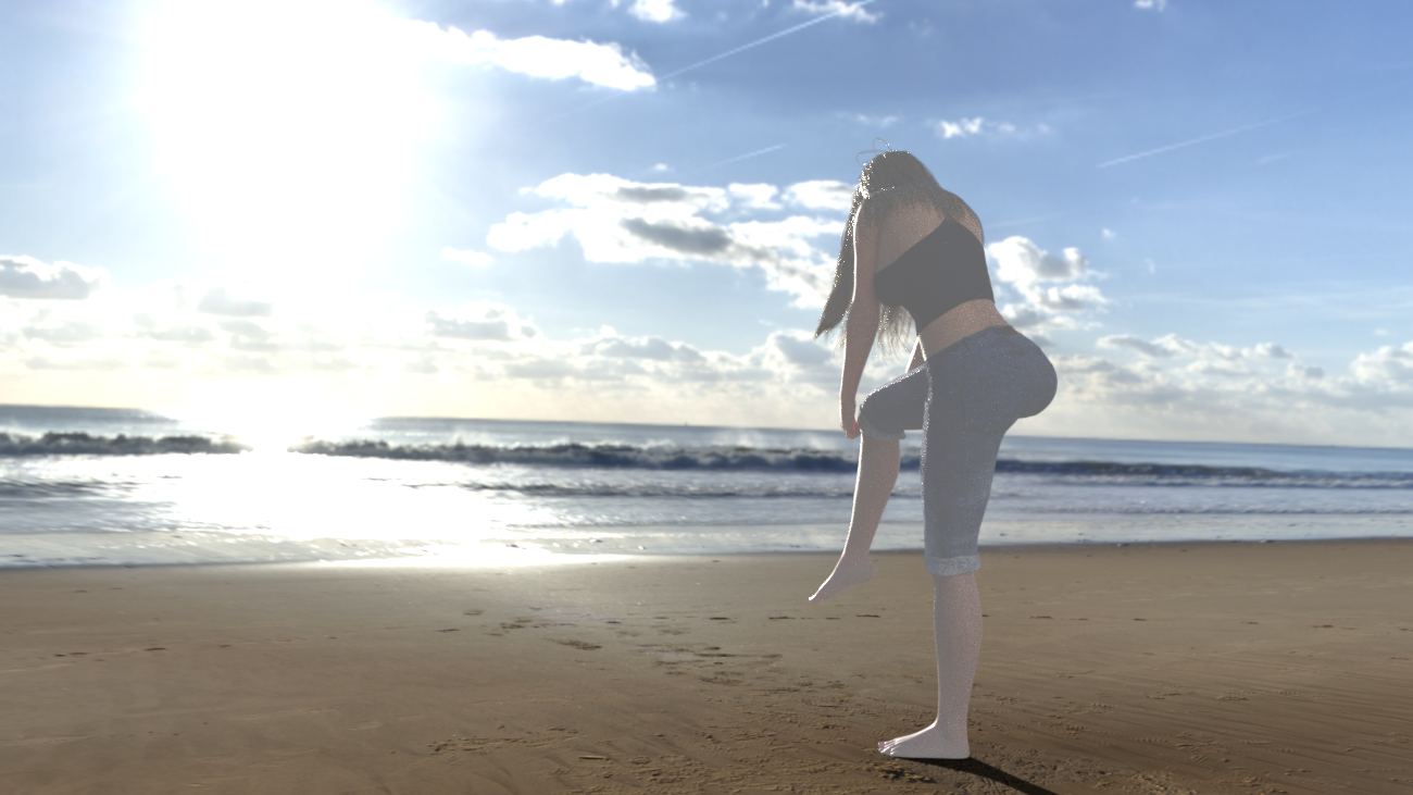

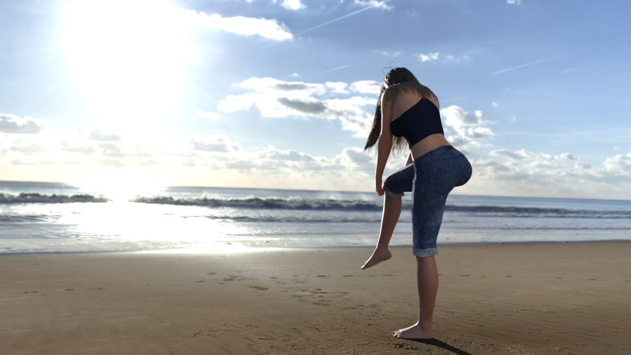

    Science marches on!  So after I was investigating something else, for science, I thought I'd give Matte Fog another whirl, and well, it disappointed me.  Turns out, Matte Fog has some limitations!
    Here's a figure with just an HDRI for lighting.  There's a bounce next to the camera to provide some reflected light.  The Matte Fog appears to have no effect on the HDRI, whereas it has a very significant effect on the figure in the image.
    No Matte Fog or anything.
    Matte Fog set for 100m.  Other settings default.
    Matte Fog set at 100m. Brightness Relative to Environment OFF because I was curious.
    So in a case where you are using an HDRI as background, there's still no quick and easy substitute for an atmospheric prop.
