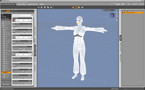

    I noticed that as well, the 'Ambient' Color and Strength is a bit high in the "Surface(Color)" tab settings for the teeth.
    It takes some adjusting of the color to get it looking correct, I'm not that good at it yet.
    Jumped to other comp to post screen-cap of the tab.
    1924 x 1200 - 208K
    "O" you can also change the 'Diffuse' color to darken the 'Diffuse Texture' textures as well.
    it's the box with the numbers to the right of the small picture.
