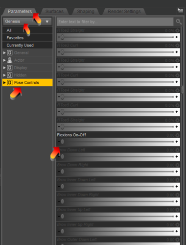

I am under the impression that the Genesis Evolution: Muscularity should be automatically applying when a character is moved, and requires no input on my part, correct?
If so, it does not seem to working, as if I (for example) bend the foot, the calf does not flex (like in the Muscularity example video on youtube), etc.

Nope, first you need to be using the Muscle morphs in the figure at least some... as in dialed to at least use Fitness or one of the others that call the morphs then you need to set the Parameter to Flexions ON.
