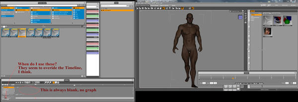

For the last week I've been struggling with trying to get two Poser mocap sequences (from Everday moves) to work with the Gen 2 figures in my scene, but sometimes the figures jump back to default pose when I add a keyframe in aniMate2. It's sporadic and I can't correct for this, there is no undo and deleting the key doesn't help, so I have to reload the last saved file and hope it won't happen the next time. I tried following your earlier steps and still need to buy Graphmate and Keymate, but I don't want to spend more money if its simply not going to give professional results. I tried importing my scenes into Max, since I know how to use that timeline better, which is a piece of cake by comparison to DS. All you basically do there is decide what part to move, any part in the scene, and move it, and then add (+) the key. I guess I was thinking I could use that approach with DS, but sometimes it simply chokes, holes in the programming or 3rd party not in sync. I love working in DS, and all the cool stuff you can do, so I am really trying to make these work. If you can answer a few more questions, I would really appreciate it.
I can actually do most of my tweaking while still in the aniblock stage of aniMate2. You simply set new keys for each part you want to tweak. There's a few ways to do this. I don't see the point in baking it for Daz timeline to use as I can't go in and adjust areas except to do the same thing - move a part, hit the plus (+) key. Here is the problem, though, sometimes when I do this in either, the arms will shoot around the chest and get stuck there. Then I have to go in, frame by frame, and literally adjust every one of them, guessing as I go, which leads to jumpy video. I tried several ways to correct this, from copying one frame that I adjusted, move several frames ahead, then try to paste this fix into the arms. It never works. I tried pasting one by one, it works, but back to the same problem of it being jumpy. I tried pasting into multiple parts- like on the animate2 timeline after I select, say, both shoulders of the figure in the Scene tab. Now, this should work, but it only takes one and for only one frame. A waste of time. Do you know of any better way to fix parts that go kerflewie! I assume that's where Graphmate or Keymate come in. Do these programs work well? Are they easy to use by comparison? I mean, do they react to the key adjustments properly and is it programmed well so its consistent?

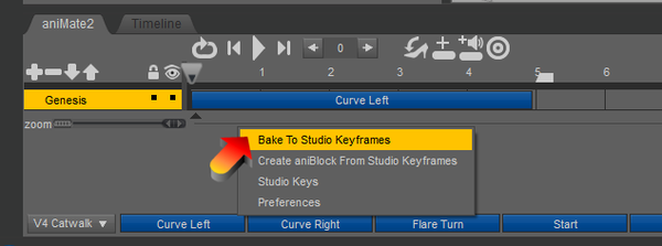

OH! One other thing- what is the purpose of saving the aniblocks? I assume to reuse on other animations, but I don't see that it's necessary. Is it just to make sure that when you bake the aniblocks, if it goes haywire, you have a backup?
I tried baking from the aniMate2 window (right clicking) and it took the info and baked it, I think. I don't know where it went but nothing seemed to have changed. I then saved it as a scene subset, which at least gave me a dialog box and that one I know saved. I think I can call these saved subsets up when needed...? I'm the type of person who will make dozens of these presets for the possible use... somewhere down the road. Just want to make sure I'm doing it right.
