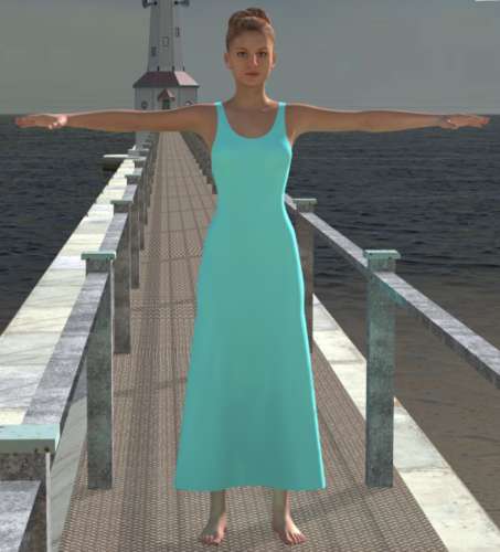

    So, as a test, here's what I did... First, in D|S, I exported G2F as an OBJ, but set at Poser scale selection. I then imported the OBJ into Poser Pro 2014. I found a dress I had made for V4 in Hexagon, and loaded into Poser. It was a somewhat close fit, but I did shrink the dress a bit, then scaled down G2F, and ran a 5-frame simulation, bringing her back to 100%, and the dress fit much nicer, but didn't do a full-scale drape. I then exported the re-fitted dress, reloaded G2F, and imported the fitted dress. I then ran a cloth sim, and the dress did drape, but it doesn't look too impressive in the zero pose. I did a quick render of the result in Poser Pro 2014, as seen below.
    543 x 600 - 579K
