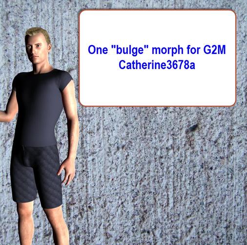

In putting together a character using G2M, realized it was missing something. After converting the M5 pro part to G2M, decided to also make a bulge morph for use under clothing.
If anybody else wants one too, here it is: DA Link
937 x 926 - 226K
