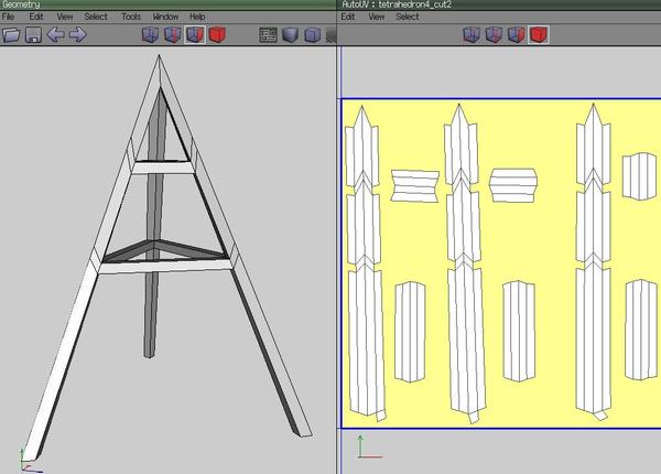

    this as far as i've gotten with the Foollin triangle so far.
    pondering the logic of chain links. don't want the metal of the chain link to bend, needs it to rotate in it's neighbor.
    1010 x 723 - 90K
    I'm working on a biggish chain-related product, and my advice is, set up groups (one per chain link) in your modeler and export to obj that way, then use the Figure Setup pane to create the figure's rigging (right-click in geometry, navigate to it, drag it to the hierarchy, then drag the bones onto each other in the right order). The nice thing with chain links is that it's then one click to weight paint them with proper rigidity (using "fill weight by selection set").
    The fastest way to do this is to model the chain itself flat on the ground so you can just leave all the joints at XYZ rotation, then pose it, parent it to the frame after it's rigged, and save as a smartprop or scene subset.
    Never try to make a chain a conformer unless it's jewelry or something else that doesn't need to move link by link.
    Post edited by SickleYield on
    thanks :)
