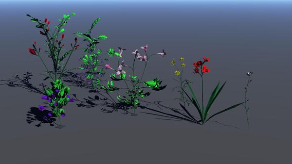

Below are a few Plant studio objects I've mucked around with as well as a few bryce flowers for comparison.
What are your thoughts on the matter?

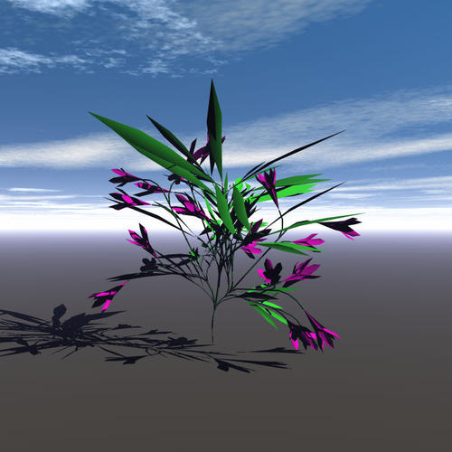

    Below an example of an exported PlantStudio2 plant. The first image shows the angular appearance in Bryce.

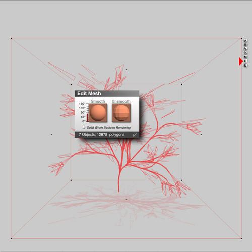

    In the wireframe view in Bryce, select the plant and click on [E] (red arrow). This opens the Edit Mesh dialog. Click the Smooth thumbnail. On the lower edge, you'll see the progress.

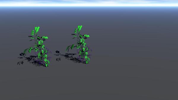

    The third image shows the result.
    Now - you can also smooth only individual parts of the plant. You have to select the part(s) you want being smoothed.
    On the left side of the Edit Mesh dialogue you see a scale of degrees and a red bar. You can move this bar up or down to set the smooth angle. The default (around 85°)usually gives the desired result. If not, experiment with other settings.
