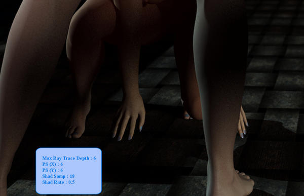

Early stages of creating a female Blacksmith. Test Renders with 3 light sources are producing horrible dots all over the image instead of contrasting shadows. I've played around with many of the light settings to no avail. Help please.
1695 x 779 - 287K
«1
  • JaderailJaderail Posts: 0
    edited April 2014
    Which light is the Uber Light? The Distant the Point or the Spot? That is from the Samples being set to low. The Ubers load at 8 Samples, I will not render at less than 64 Samples for a Uber light. Be warned Render times go up with the Light Samples on Uber Lights.
    Post edited by Jaderail on

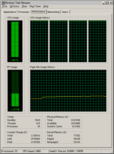

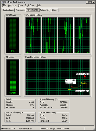

    I was able to get Genisses 1 (Bare foot dancer) and that "Sally May" hair to render, Genisses 2 requiers much more ram.
    That Task Manager 'Performance' tab is your friend. I know if the ram even spikes past 1.2GB on the graph here, it's game over.

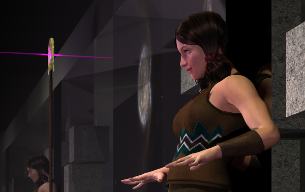

    The above "Casting Reflections" render was done at SR = 0.10, Ray-trace-depth = 5.

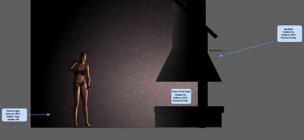

    Well my problems continue. An all new scene with three lights, no enviroments/uber.
    Distant Light : Intensity 50%, Shadows On, Raytraced only, Softness 20%
    Linear Point Light : Intensity 80%, No Shadows
    Spotlight: Intensity 70%, Shadows on, Raytraced Only, Softness 32%
    I would have pasted the whole image but there was a nipple visible and two gluteus maximus. Wouldn't want anyone at Daz having a heart attack would we. ;)
    1214 x 784 - 245K
    Fascinating [raised eye brow]
    Try a cropped 1024x768 pixel test run with a new default-stings 'camera', the aria shown is fine.
    I usually try to keep the digital stuff at multiples of 8 for the shadow samples (16 or 24), Never tried 18 before.
    If that dose nothing, try 0.2 Shading rate.
  • ewangrant1ewangrant1 Posts: 0
    If you think the area shown is fine you must not have clicked it to enlarge. It's horrible.
    I will try multiples of 8 first, then 0.2
    What is a pixel test run?
    And there is nothing going on in that picture, though I agree the cropped selection is intriguing. They are both females, one law enforcement, the other out after curfew and she has been cornered. They are either not wearing clothes because: it's a high humidity planet and everyone is naked; or I don't have appropriate wardrobe; or I like looking at naked women. One of those, possible all.
    edited April 2014
    saying the cropped aria of what you posted is fine, as it shows the "Opertunity" without showing stuff.
    set the output render size to 1024x768 pixels, for the test runs. so the renders go quicker.

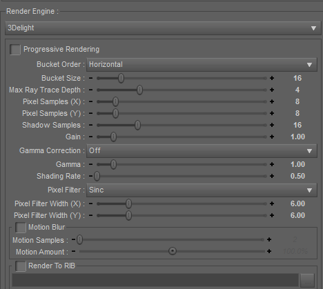

    Hm... Max Raytrace will only effect Glass, and or reflections, and is prob not needed to be above 4 here, maybe even 2.
    Let me think... Not one Uber light , none at all, so no Render Samples can be causing the fuzzy look.
    Try this as a full render setting.. it might take a bit of time to run... this is the adamr001 Average render setting for DS4.6...
    468 x 419 - 16K
    edited April 2014
    yea, and if render settings cant fix it, it may be that "Lizard Skin" effect.
    Anti Aliasing of 8 instead of 6 or 4, hmmm.
