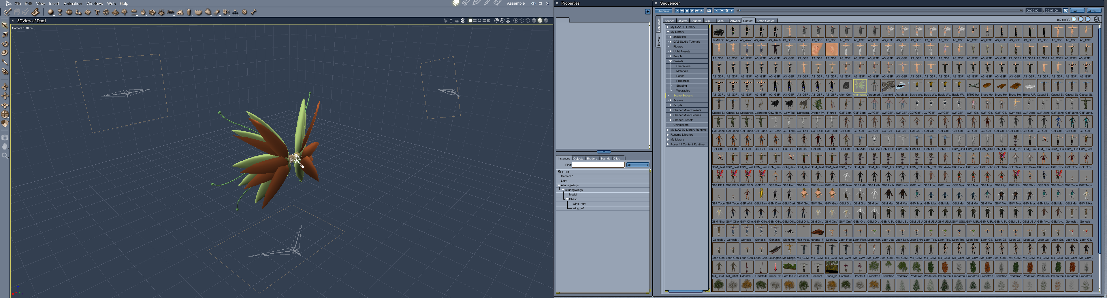

    thanks I'll give that a go!

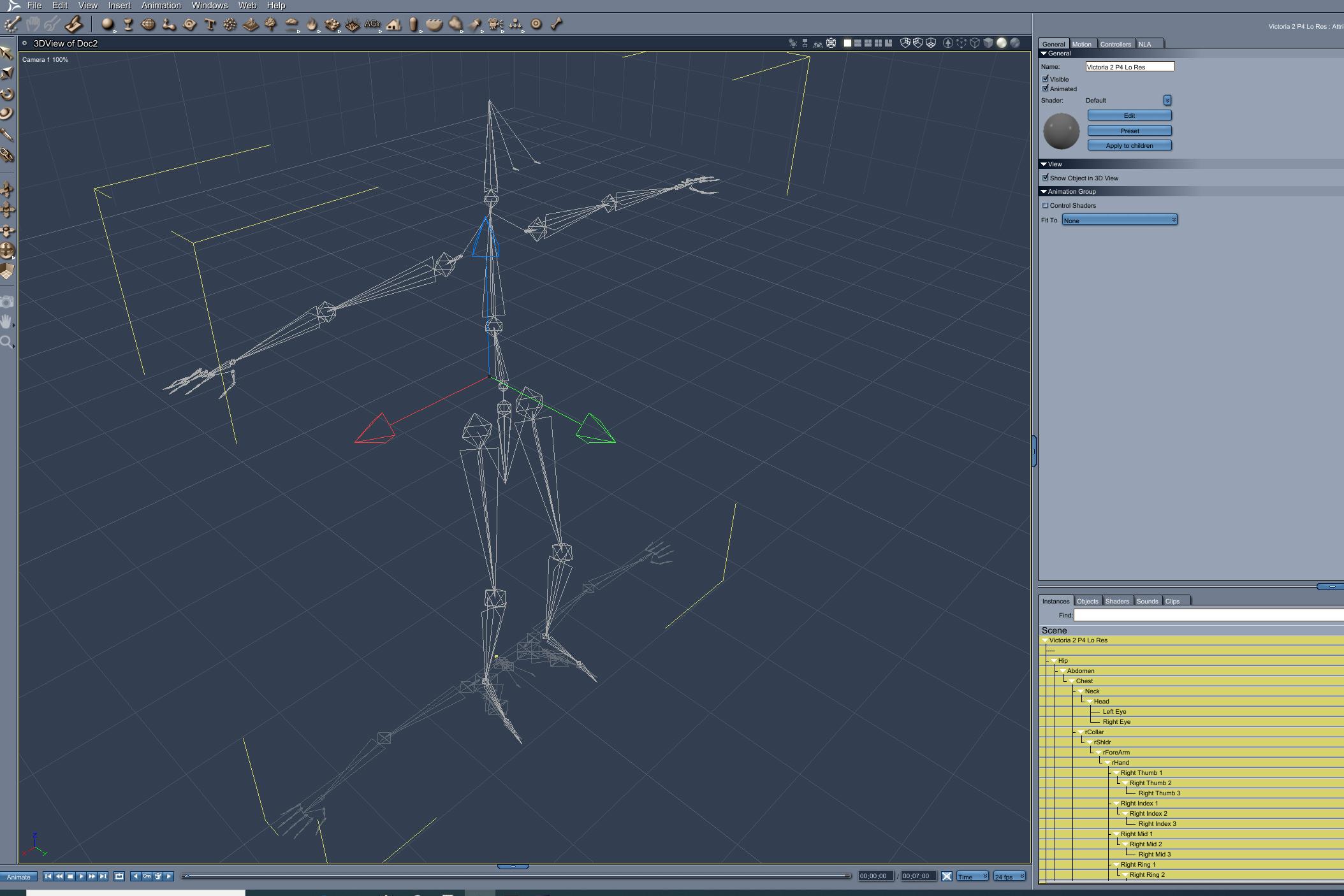

    it happens with all figures = eg V ictoria 2 Lo Res comes into Carrara without a body.- see pic - there is no model in the instances list

    Haha just did a search for v4 obj and yes she is installed in four places - but not in the latest drive that I got dim to download my entire product library ... not sure what is going on there.
    It was working fine before I downloaded my entire library - I changed the name of the file that DIM uses to see what it has downloaded so it would download everything.
    Maybe that's the clue?
    I'll try loading her up from the ds structure - but iyt is a problem with all figures - they load into studio okay but dont come into carrara via the duf file...
