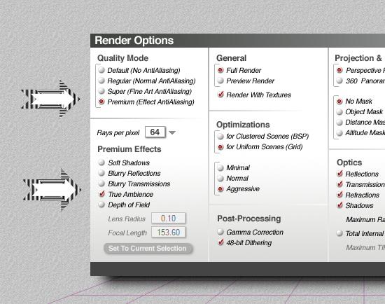

When I try to turn on True Ambiance in the Render Options, the option is greyed out and no matter what I do I can't get it to come back. Does anybody have any suggestions I could try? This is driving me nuts!
  • Miss BMiss B Posts: 3,071
    You have to click on Premium (Effect Antialiasing) in the Quality Mode section above. That will turn on the Premium Effects, including True Ambience.
  • HoroHoro Posts: 11,740
    @sithkitten - Miss B is right. Just a tip: True Ambiance (TA) renders a bit slow. While developing your scene, set the Rays per pixel low. This will give you a noisy result but it is fast and helps you tuning your scene. For the final render, set it high. Most of the time you'll need 256.
  • David BrinnenDavid Brinnen Posts: 3,136
    Do check what version of Bryce you are running. https://www.youtube.com/watch?v=BSwkqFCX0Fg
    And if you want to, you will also find very many videos about TA rendering on my channel. https://www.youtube.com/user/davidbrinnen Which in turn will guide you to all manner of tutorial if you so desire. http://www.bryce-tutorials.info/bryce-tutorials.html
    If you are running an appropriate version of Bryce, then checking the premium effects option should allow TA to become available.

  • kittenwyldekittenwylde Posts: 151
    Thanks for the responses! Unfortunately, the first thing I did was turn on Premium (Effects Anti-aliasing), because I know it's necessary. All the other options became available, just not TA. I recently upgraded from XP to Windows 7. Is it possible something got broken during the re-installation process?
    @Horo: thanks, I've never tried going as high as 256.
    Have you inputted your Pro serial number? Maybe Bryce thinks it is running in PLE mode?
    Hmm... I hadn't thought of that. I just checked, it's version 7.1.0.109. I'll go try the serial number thing right now. Thanks!
    Yes! That was the problem! It had the serial number for the standard edition. Thank you so much!
