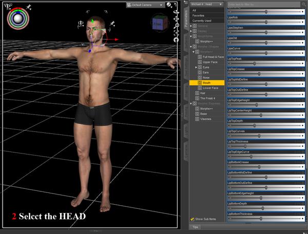

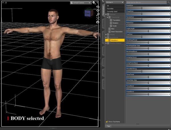

Poses will apply straight away, and you will see them in the Viewport, morphs need to be dialled. When you have applied your morph, go to the Parameters pane (with the Head selected), and you will find sliders there for the morphs that you have INJected.

Ok if they don't show up as my pics show then you need to find the DzCreateExPFiles-M4.bat file and double click on it to Initialize the Morphs the file should be located here C:\Public Documents\My Daz Library\Runtime\libraries\!DAZ\DzCreateExPFiles-M4.bat if you have a default installation. Also did you install the morphs to the same directory as M4 Base. After Initializing start with a newly loaded M4.
