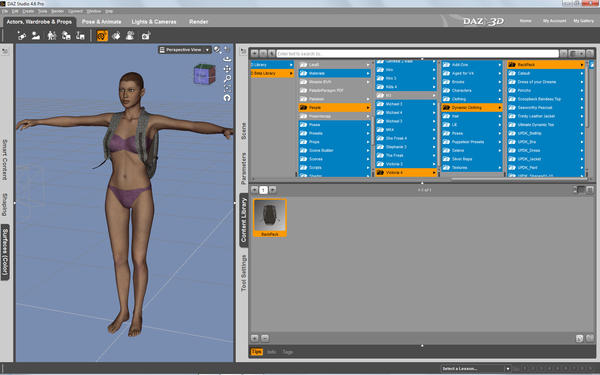

I can post the file list if you want. It's not expensive, but I expected it to show up in Content/Smart Content (gawd knows everything else does!)
I can open DS and put a V4 figure in but the backpack, though listed, is invisible! Doesn't show up if I try to put it on her.

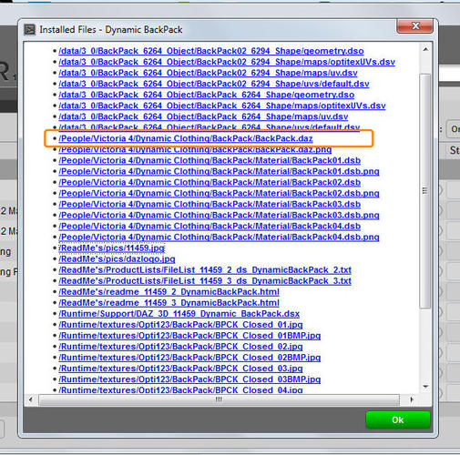

    This is a DS only product because it uses the "Optitex" Dynamic cloth in DS.
    Q: Are you using DIM to download and install your products ?
    It sounds like you're moving files around manually... that normally breaks the links to any additional or supporting files (the object, the textures etc)
    Products are built to a strict folder structure, and as long as DIM knows where your DS is, then it'll put all the product files where they should be.
    Dim shows this product is installed into (Daz Studio formats) People / Victoria 4 / Dynamic clothing / Backpack
    Hope it helps :)

    Andy I used DIM. There was an extra resource file...but it does not say where to put that. Or is THAT already included in DIM?

    The "Resource files" from the product page, are the UV map templates, to help you to create your own textures in an image editor or paint program like Photoshop or Paint-shop-Pro. and the product "Read-Me" files.
    The ZIP file is for Mac's, and the EXE file is an installer for PC,.
    Because these templates are just images you would use in another program, they don't need to be installed into any specific program, such as DS or carrara.
    You can install them into a folder somewhere, then maybe copy the actual "UV templates" (jpeg images) into a folder you use for images. and uninstall.
    I think it's a little bit OTT, to have an installer for the uv maps, or no explanation on the product page of what these files are, how they're used.,. but I suppose the web site is still a WIP.
    Hope it helps :)
