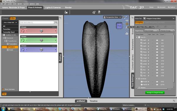

    Like I said before, the mesh is pretty tight. It's actually got more in it than I wanted. When I told blender to unsubdivide, it would add criss-cross edges and I didn't like that. So I kept the mesh. It's actually based off a merchant resource skirt for Cookie.
    So here's step one. I have my face groups set and ready to go. They've been given new breaks, more even divides. I also split the tail into two parts even though the tail wasn't originally going to be that way.
    1440 x 900 - 211K

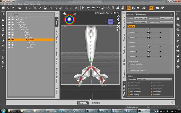

    Okay now I have my rigging set up. I left the axis at the default. I've read again and again about where x goes and y goes and never can seem to get it straight. Hypothetical directions are a BIG failing of mine. Took me 30 years to get vertical and horizontal straight and I still have trouble with them, no joking. But in the past the default worked good enough so it will be fine.
    1440 x 900 - 172K
  • Richard HaseltineRichard Haseltine Posts: 111,516
    You'd want y as the first axis, since that's the "lengthwise" direction. Whether you want yxz or yzx would depend on how you want the tail to flex - front-to-back, like a dolphin, you'd want yzx (because the x is going to be bending more than the z), side-to-side, like a fish, you'd want yxz (because the z is going to be bending more than the x).
    Cookie and Chip are legacy rigged items (they are Poser figures) as far as I know, so you may be storing trouble up for yourself by making the tail a TriAx figure, at least when it comes to getting it to join smoothly to the body.

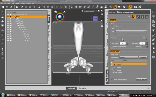

    Anyway, this is where things break down. I have the top parent node selected just like in the tutorial. I have the weight brush selected. I've made sure it looks like his. My figure is not red. I got it to go red once last night.It's not going to do it again. I have no idea what to do to change this or get things to work right from here. I can go through the steps again just like I did before, but why... if DAZ is going to ignore me.
    1440 x 900 - 171K
    If you are using the latest DS they have changed the way the weight maps work so that an unweighted figure is neither blue nor red, but you should see colours once you start painting.
    The first axis is twist, rotation in place about the axis, so having x or z first will not work for this - it's whether x is second or third that is optional.

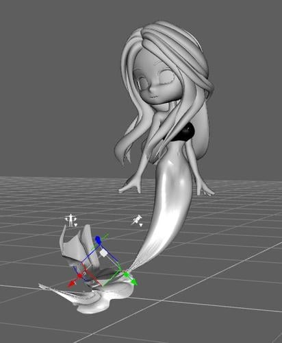

    The tail is on it's way, and I wanted to thank everyone for their help. Now I have to work late tonight to make up for "getting sucked into the tail" time. LOL... but worth it maybe. I'm thinking I need to rework the base a bit as it doesn't quite look like it belongs on Cookie... but I probably won't. :-)
    I have basic boning in, but I had to put it in Triax format to get things to move how I wanted them to. I found a tutorial earlier today for adding pose controls so I guess that's my next step.
    Weirdly when I add smoothing and push modifiers it does weird things.
    So it is on Cookie (who is not nekkid, don't let the grey fool you). To put it on her I told it fit to. When I applied the pose I simply put her x and y coordinates back to 0. To get it to fit her hips, as I cookie doughed the body, I originally did a tweak but it straightened out after the pose. So far so good I guess.
