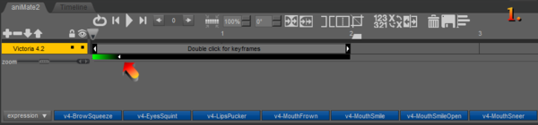

    However each aniblock "zeroes" at the beginning an end which creates a bit of jerkiness. How can I make each aniblock morph smoothly from one to the next?
    As explained above I prefer to use Dialed in expressions on the DS Timeline, that prevents the need to edit or adjust the Expression AniBlocks. You can Single click an AniBlock to get into level one Edit mode in that you can extend or lower the BLEND setting for the AniBlock. See image one below.

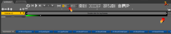

    How can I slow an individual aniblcok down? I want some to change expression faster than others. In image 2 you see the Speed of the AniBlock, in Image 3 I have lowered the Speed of the AniBlock, as you can see it now plays slower but longer on the Animate Timeline.

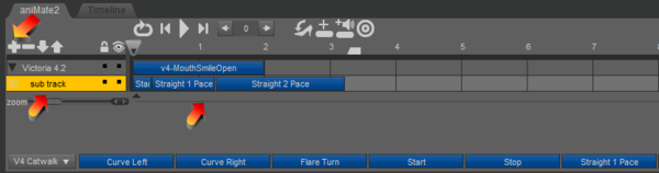

    vindazi said:
    How do I "layer" the ani blocks"? I.e., how do I get more than one aniblock action at a time?
    That is Done in AniMate2, not sure if AniMate Lite will do it, with the Figure selected you click the Plus on the AniMate editor, it adds a Subtrack for the Figure, you can have many subtracks.
